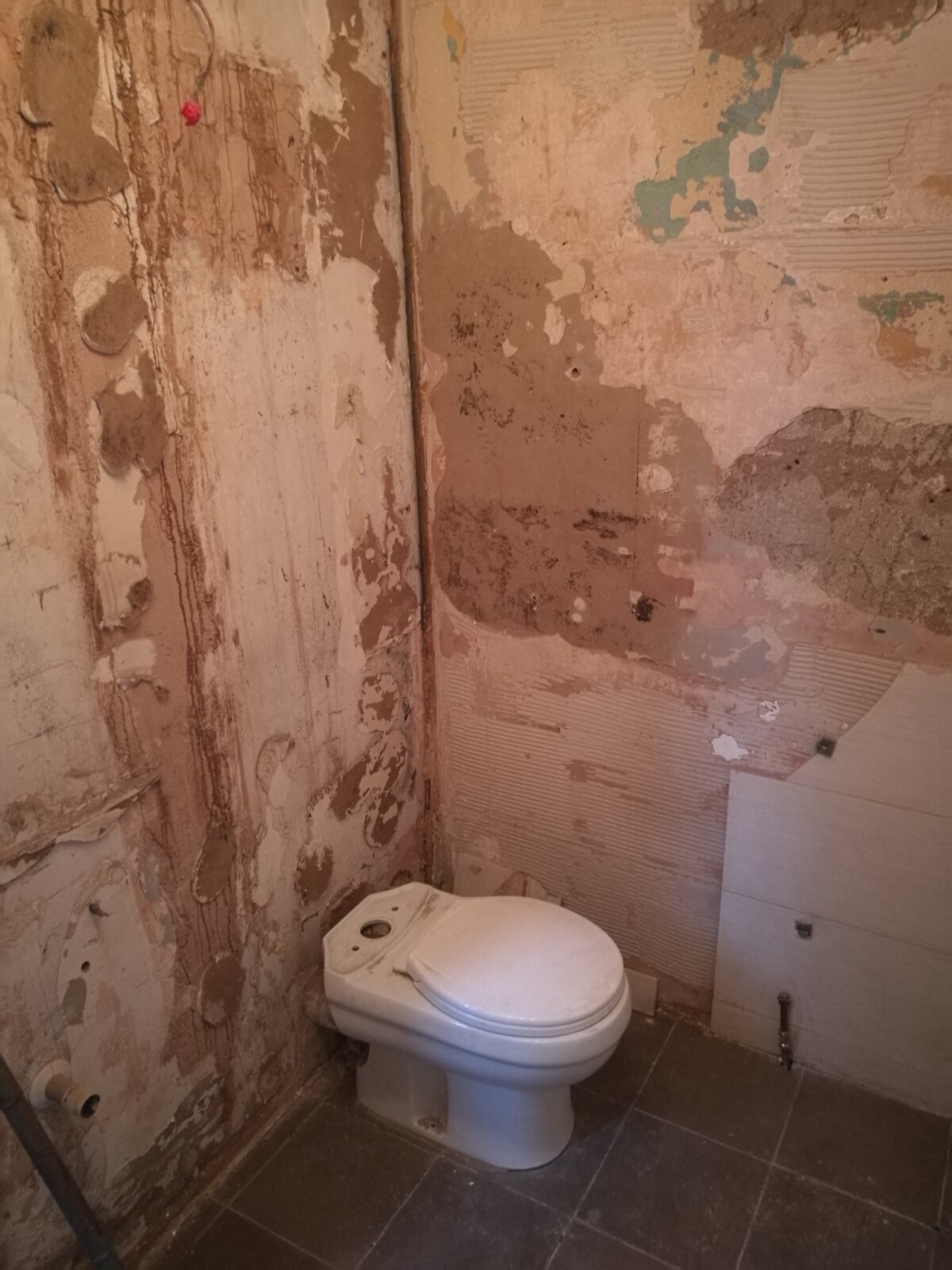

We are renovating the bathroom in our ground floor flat, in a Victorian terrace converted in 1990. On the back wall (brick) there are layers of old bonding and plaster under the tiles. See picture. There is a patch of old plaster on the right hand side, that sits on top of the brick. It's pinky brown colour. Seems to have dark hairs in it.
Any ideas what type of plaster this is, please?
I need to decide if we are going to strip it right back to the brick, or just layer over it. Thanks!

sounds like old plaster with horse hair added. common practice until the late 40s -50s.
or it could be jointing material , the old fashioned version of scrim tape.
most important thing is that all the walls are dry.
OP,
1900 plaster was a lime plaster that was often mixed with horse hair - your walls show various kinds of plaster patches plus dabs and lines of adhesive.
At the inside corner there appears to be a gap?
Your best bet might be to remove all the plaster back to brick, & start with a fresh surface for going forward with your project.
Hessian Scrim was the go-to "tape" before the mid 20thC - Hessian Scrim is still available, and very useful indeed in the hands of experienced, time served tradespeople. ie. People who know what they are doing.
But, from the pic you show, there would have been no need for Hessian Scrim in that position.

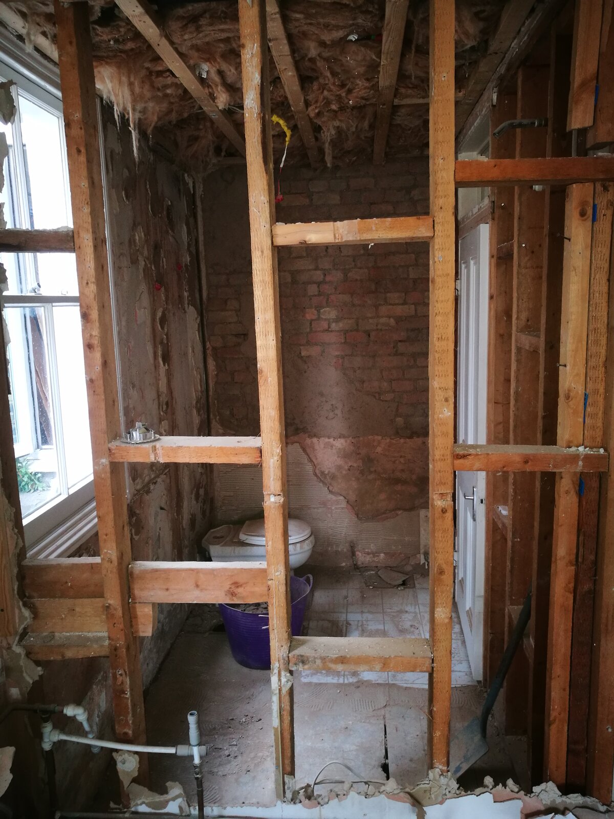

Thanks. A recent photo attached. It's the brick wall in the background. Once cleared of all surface plaster, the next step would be something like dot and dab plasterboard, then skim?
