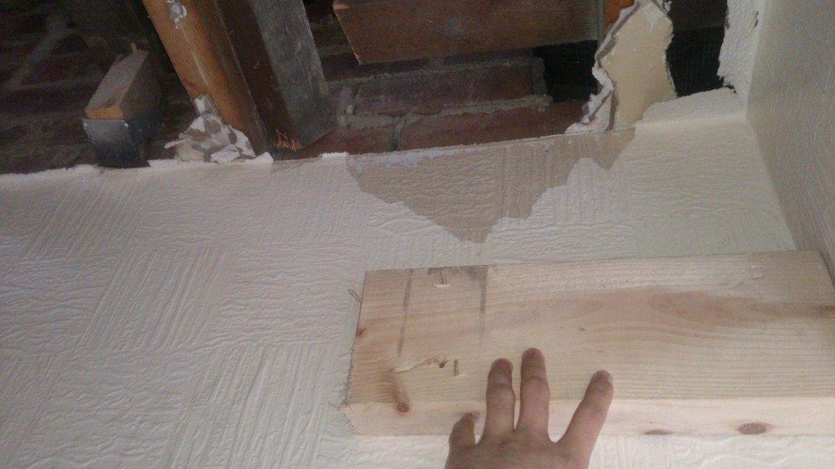

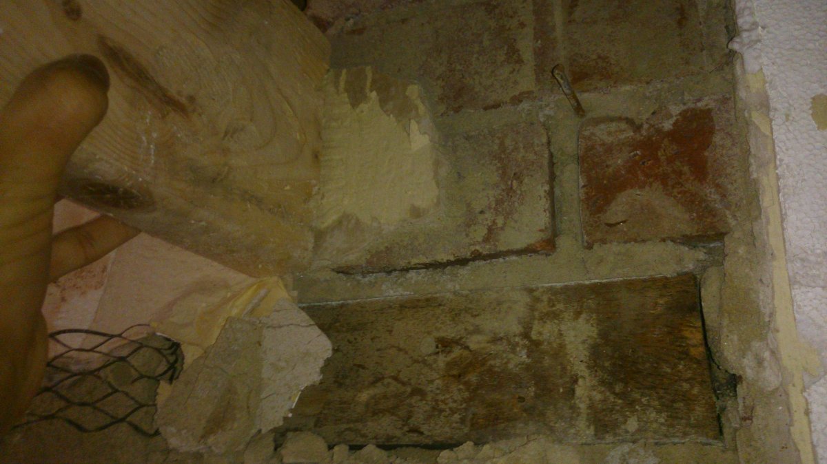

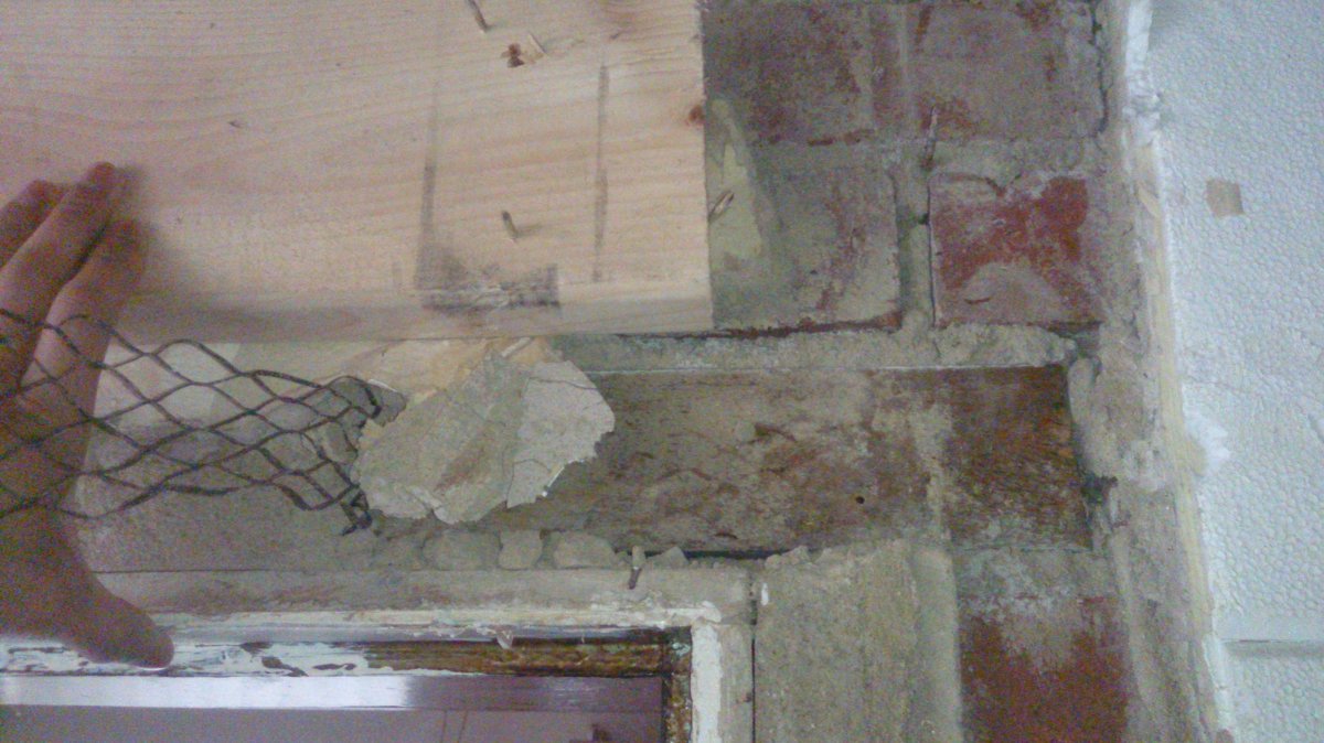

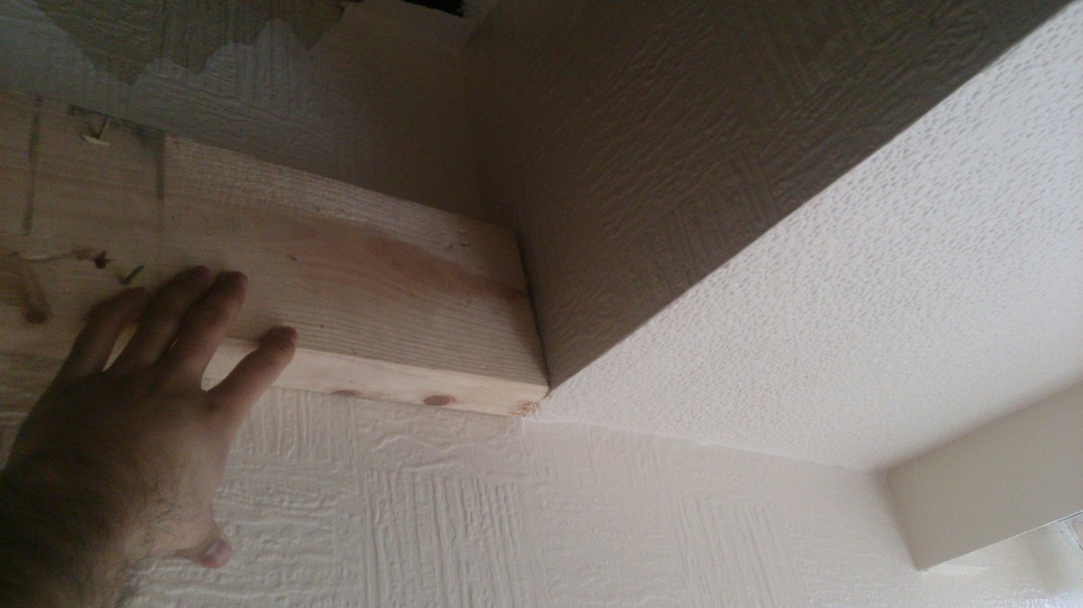

Thans for getting back to me, I will attach some photos when I go back on site today to show you what I mean. I'm looking to install the new subfloor to give a downstairs ceiling height of 2.1.. That's why the wall plate would line up with the lintel above the door.
What happens if there is only one course of brick above the brick which the bolt is driven into ? Does that matter?
I'm not worried about sound transmission woody, more concerned about having the floor level and secure that's why I want to use wall plates. The old hangers were slid into a gap where mortar was excavated but were loose and just slid out with the joist!
Hey noseall and woody,
I have attached two sets of photos.
First set are the single leaf brick partition wall and it has a wooden lintel not concrete as I thought. So I can either attach a wall plate to the bricks just above the lintel or I can sit then onto the bricks and directly above the lintel.
The other set is where I want to attach the wall plate to the party wall.. Showing the height reduction from the original ceiling joists and the joist hanger of previous sub floor.
What do you think?
