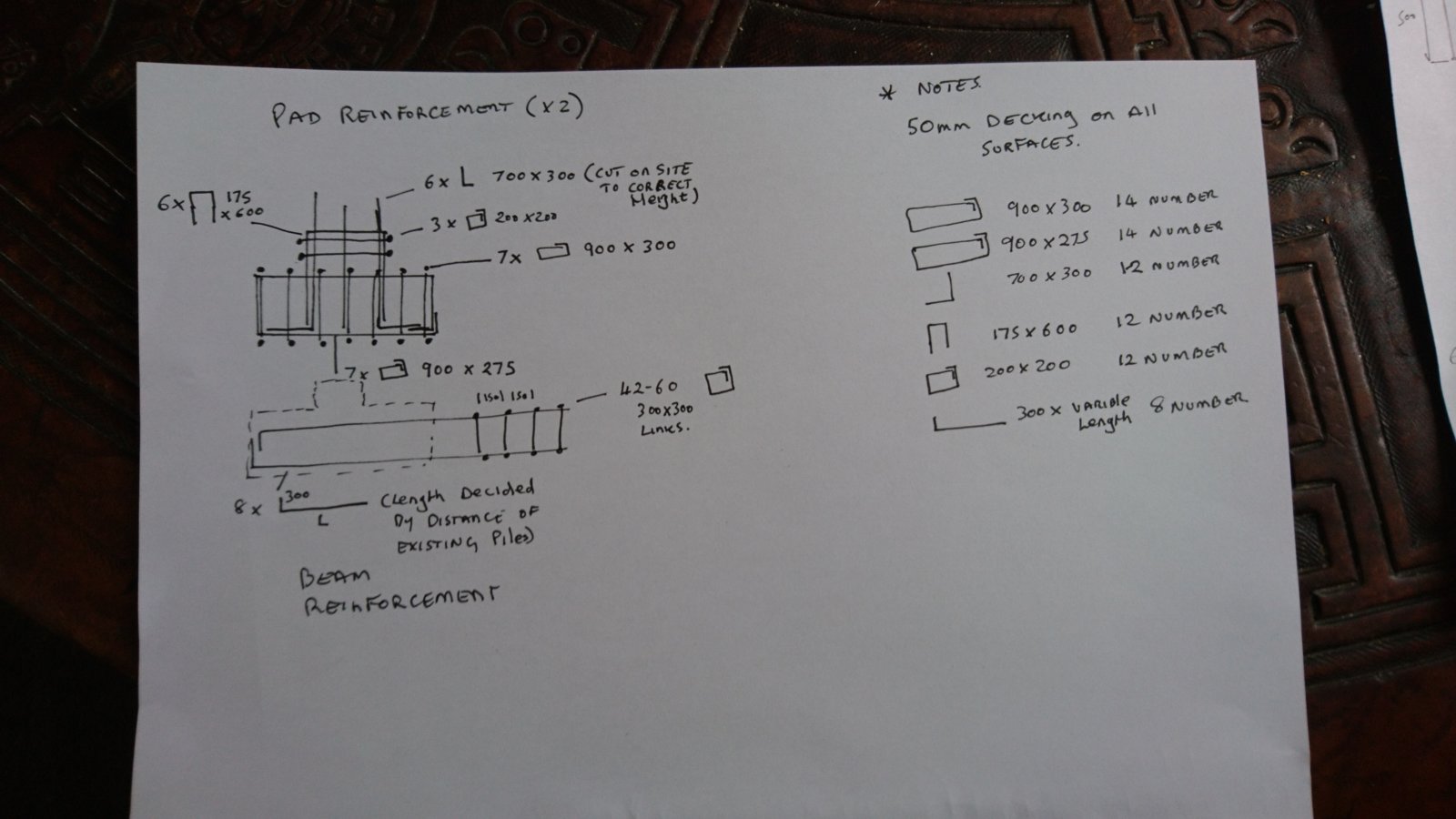

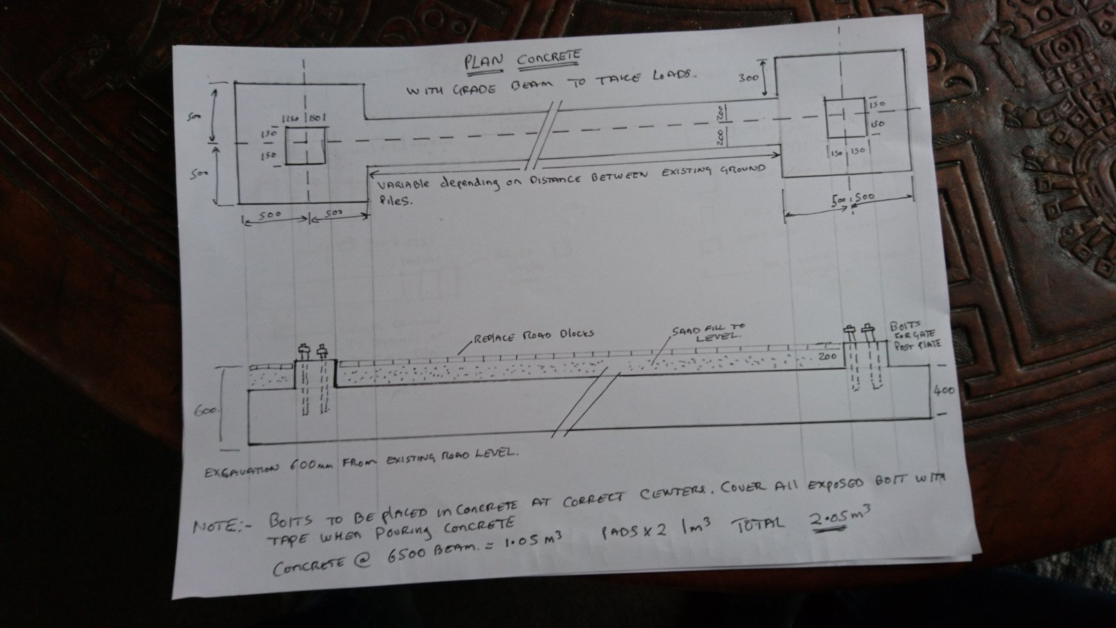

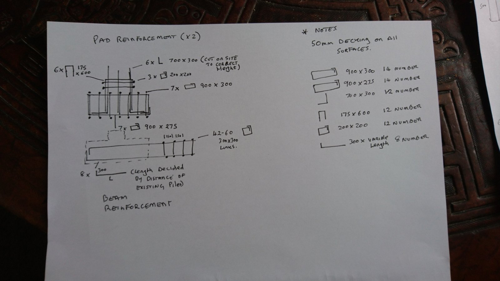

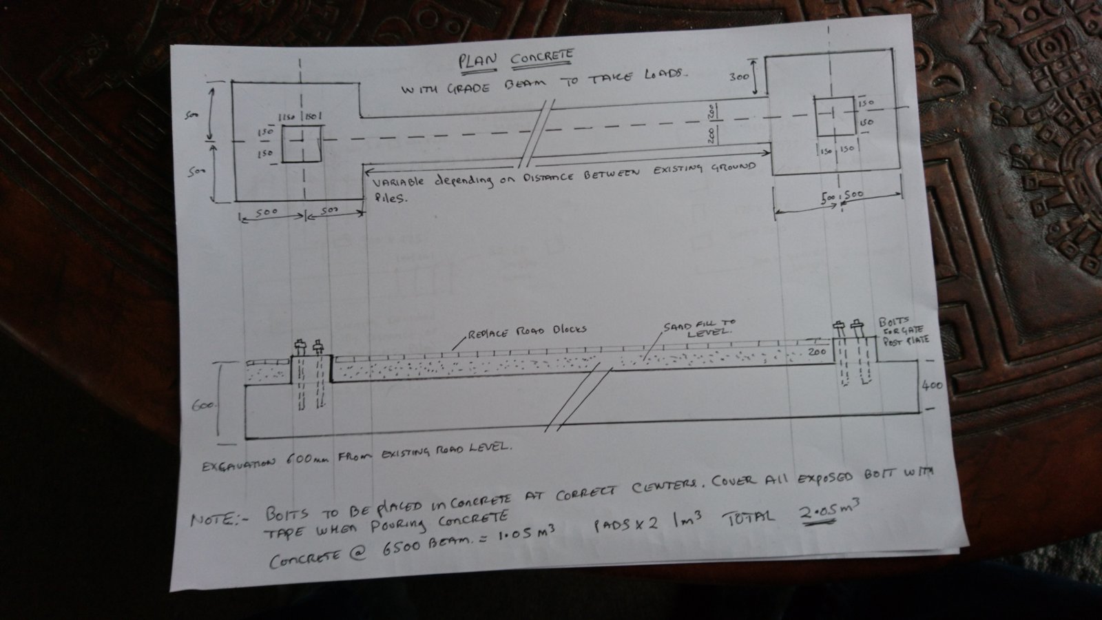

Couple of rough sketches showing the "first plan" ...
I think this is more than enough but even though I have 40 years in the game advice is still appriciated guys.

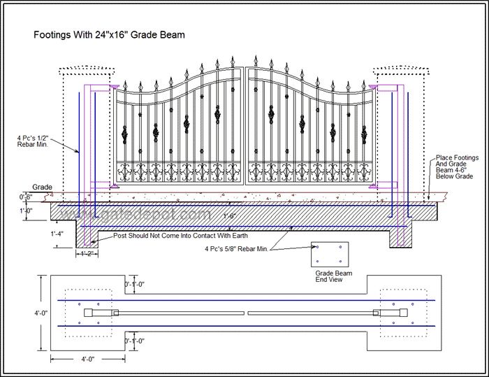

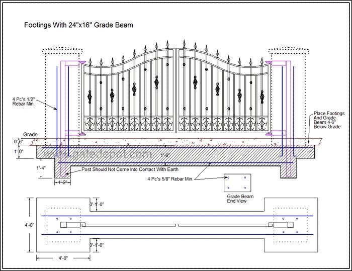

Hmm bernardgreen....now you have me wondering if the pad and beam construction is sufficient, even though I have looked online and checked this with some gate constructions.The example below is a reinforce pillar going into the footings but these gate post's I have been asked to loom at are bolted onto the pads. Thoughts on the sketches would be much appriciated.The thing is its not a money job but a favour to some mates so I need to get it right or I wont get no beer :-)#
Remember there are two directions of topple, one when the gates are closed and the other at 90 degrees when the gates are open.
The beam across the driveway will oppose the toppling forces created when the gates are closed but may just roll when the gates are open. Extensions to prevent roll may be necessary
