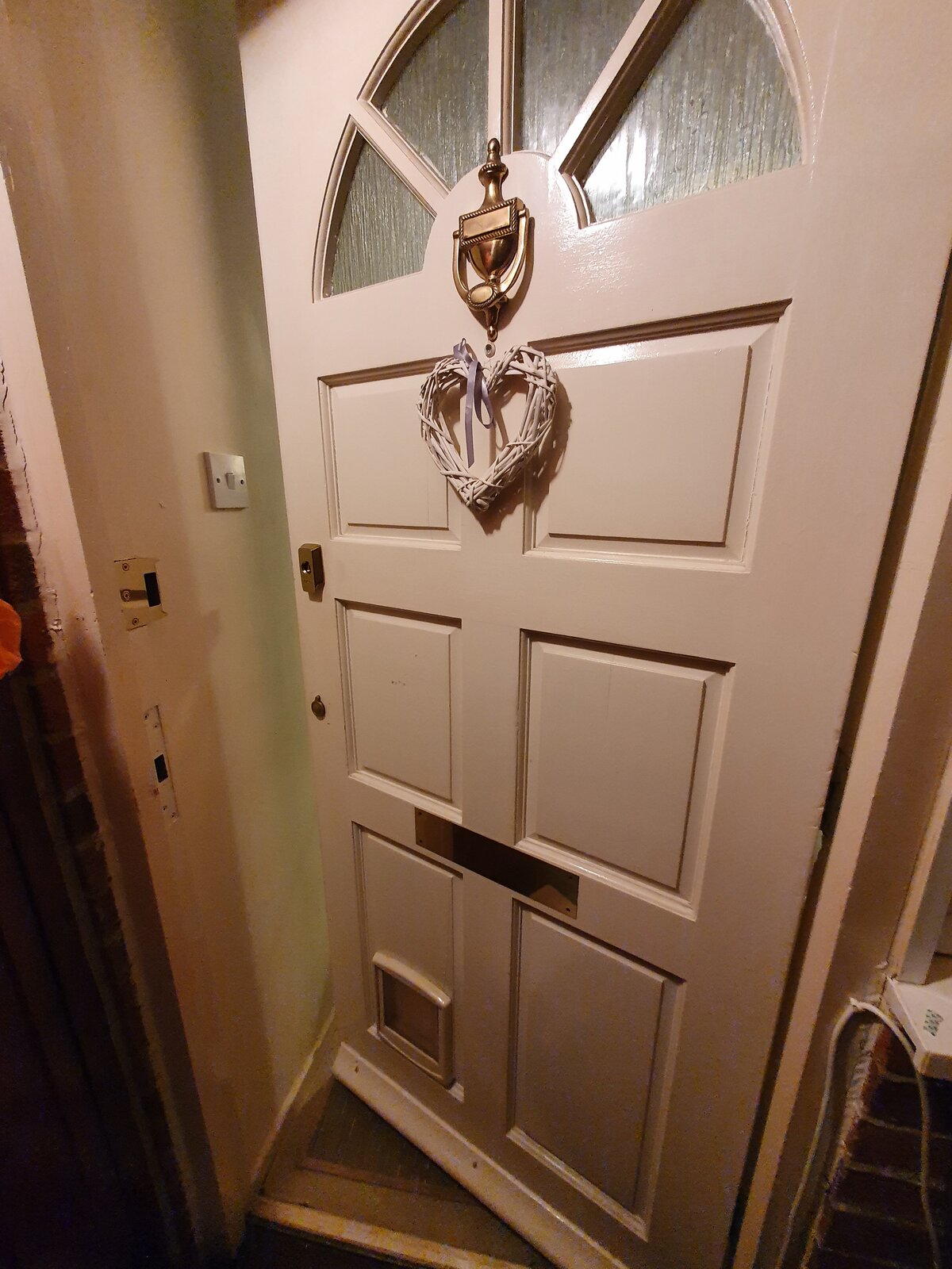

Thanks so much for your replies so far. To add a little context my front door warped inwards during the recent heatwave and can no longer be locked. At the top and bottom it's flush with the frame, but it gradually sticks out of just about 2-3mm towards the center part. It's a frame and panel front door. It happened already once a few years ago, but it sorted itself out after a few days, but this time it's been a few weeks already and it still cannot be locked. I just googled how to fix a warped door and thought I could give this a go.

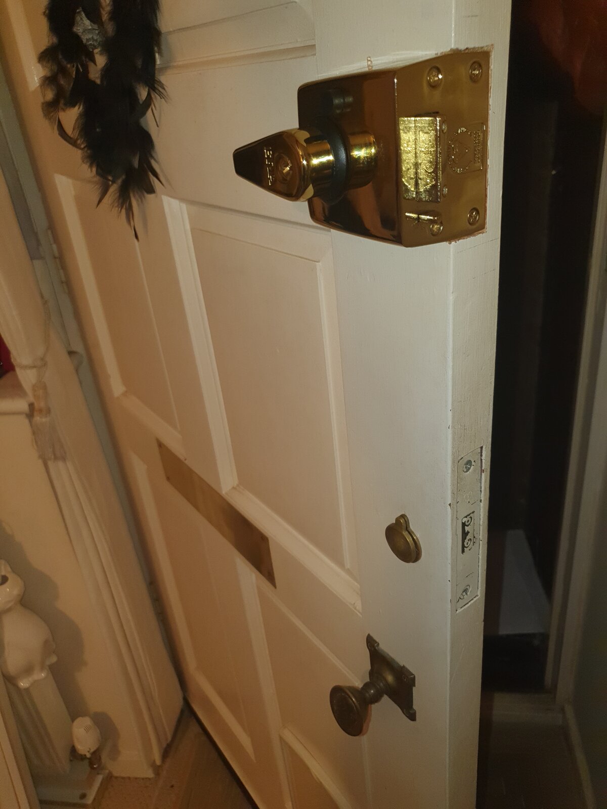

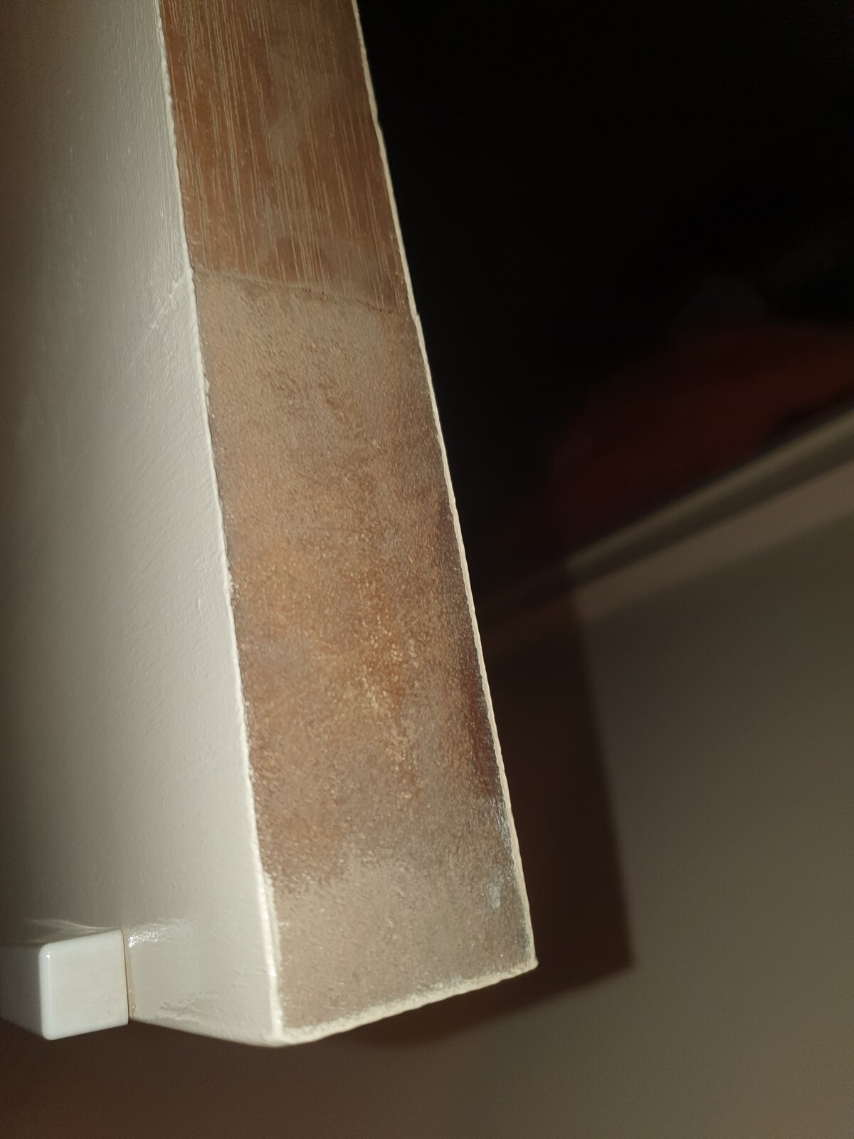

I am not sure what species the timber may be but I am attaching a couple of photos should they be of any help identify it. The door has been painted white and the top and bottom have been left bare. I am unable to tell for sure if it did fit the frame or has been planed - the impression I have is that it has not been, as it's very flat on the sides, but that's just a guess and I may be wrong, as I'm clearly not an expert. It was more than likely installed when they built the house back in the 80's, it was already here when we moved in 15 years ago. It may be worth mentioning that even if it is technically the front door, a small porch has been built at the front of the property a very long time ago, so it's no longer exposed to the elements as there is another front door to the porch now.
I'm a little wary of doing this, more because experience tells me that weighting a door down doesn't always work and that if you put too much stress into a dowelled joint or a mortise and tenon joint (the two main types of joint used on exterior frame and panel doors) you can crack the joints. With doors which have been stored leaning up against a wall (and taken on a bend) the only approach is to store it in the same way, but reversed to reverse the bend. Depending on how bad the bend is this might take a week or two in normal weather
I understand, and take your comment onboard. I will not go ahead with that

OP, I'd recommend that if (when?) it goes back to shape that you prime and paint the exposed top surface with an oil-based gloss paint to thoroughly seal it. I suspect that the exposed wood at the top of the door isn't helping the situation
And the underside.
Although not the cased here, decorators often paint the top, but cannot get to the underside whilst the door is hanging.
Agreed. It's a common cause of failure on fire doors - the bottoms rot out because they are at ground level, quite often above a threshold or seal and often unprotected unless the joiner paints them before installation. In this case I was particularly concerned by this warping, at the top of the door, potentially being caused by the timber drying out excessively - unusual, but seems to be the case
