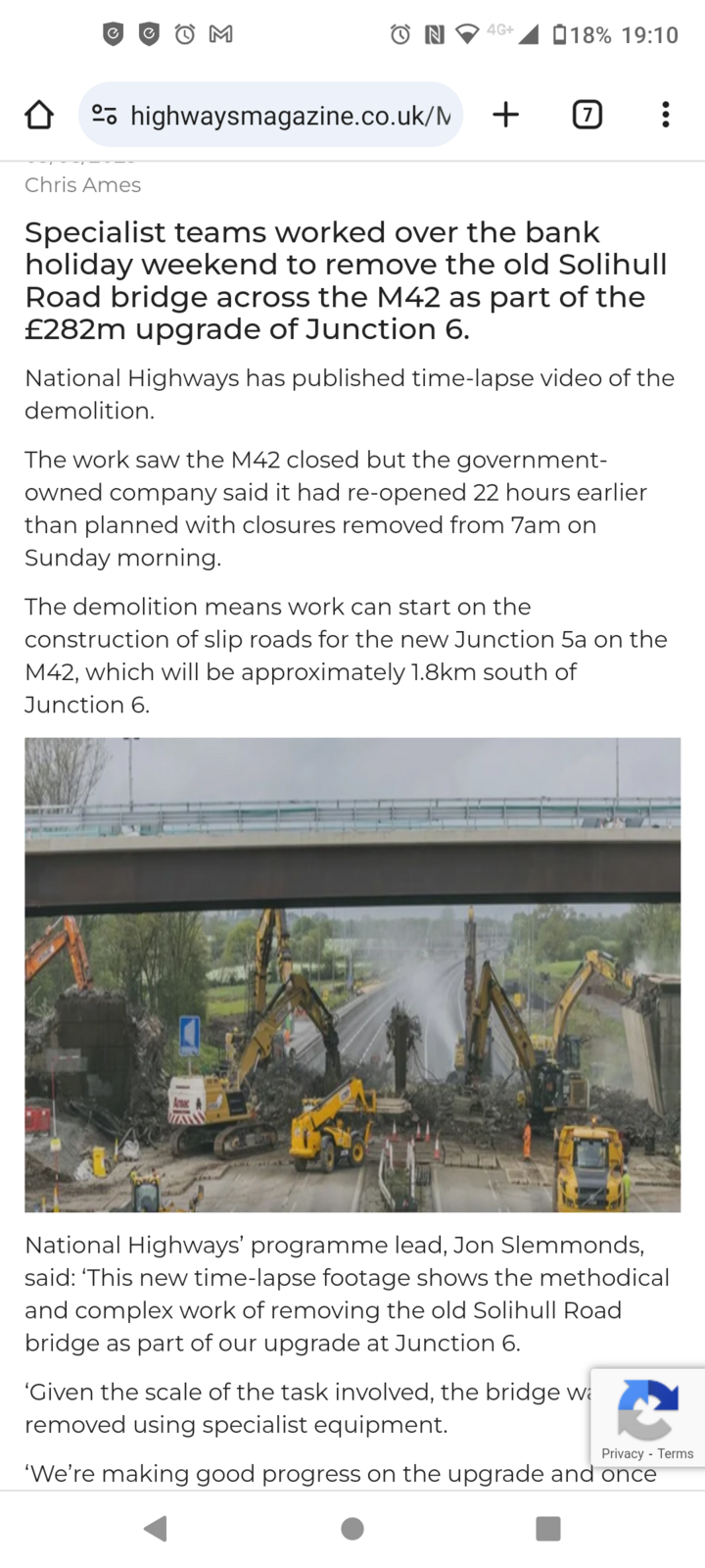

I used my Titan 1700w last weekend, it was a big job so I had to get a load of diggers to clear up.
I'm going to have a crack at next doors coal bunker next week.
