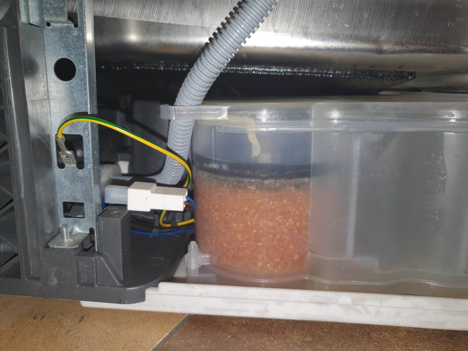

I have a AEG Favorit dishwasher, model number: F77000WOP, that keeps displaying error code i30.
i30 error code describes the anti flood device/system. The dishwasher will constantly drain when powered even if the dishwasher itself is off. The way to fix this is to take apart the dishwasher, i.e. the top, front and side panels and drain the bottom tray which acts as a reservoir to deal with the overflow. The issue is that the tray is dry and yet the error and 'draining' still persists. Does anyone know how I should fix this? Resetting does nothing as the machine doesn't stop draining.
I've added some pictures of the base where the issue should be. I'm thinking its a sensor that is causing this problem.
