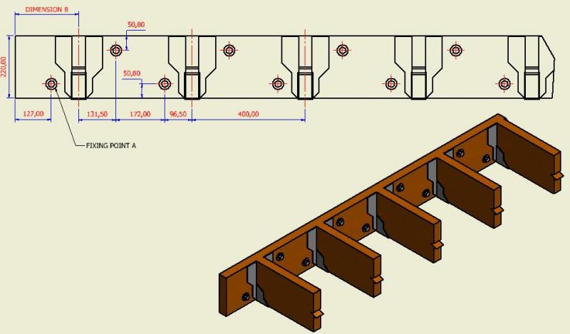

Cheers Tony,
So if a BCO came along and saw this:
He shouldn't have a problem with it?
Couple of questions I do have, is 'Fixing point A' needed, or can it be excluded?
Can 'Dimension B' be such that the hanger is right up agianst the end of the joist?
Would it be possible to use another fixing method just for the end joists so the ledger doesn't stick out past the final joist at all?
I ask these two questions to work out how to hang the joists for the edge of the roof. Don't really want the ledger board poking out through the soffits.
Cheers,
Fubar.
Unless you are using the terrace as a gym, I would say your bolting pattern is overkill.
Don't put any bolts nearer than 2" from the edge of the timber.
Fixing A could be omitted (the bearer will easily cantilever past the next bolt in);
Fixing the end joist flush with the end of the bearer could in theory be a problem because you won't have enough nails in the hanger to satisfy the mfr's recommendations. You could get the tin-snips out and try bending it round the end of the joist; in practice it would probably be OK. The end joist will probably not be loaded as much as the others.
If I'm going to use hangers, I'll be using them as per manf. instructions (all holes filled with twist galv nails).
May look at using an angle plate between them:
http://www.wickes.co.uk/reinforced-angle-bracket-e2257090/invt/214968/
With extra ladder noggins between final and penultimate joists. That'll also allow me to have a facia that actually protrudes past the wall. (ladder noggins resting on the walls)
