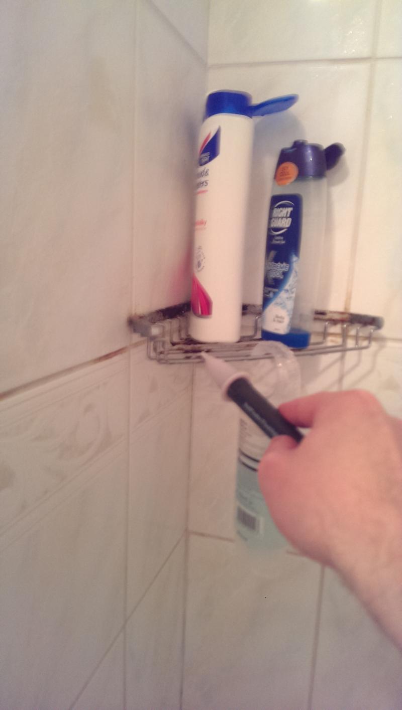

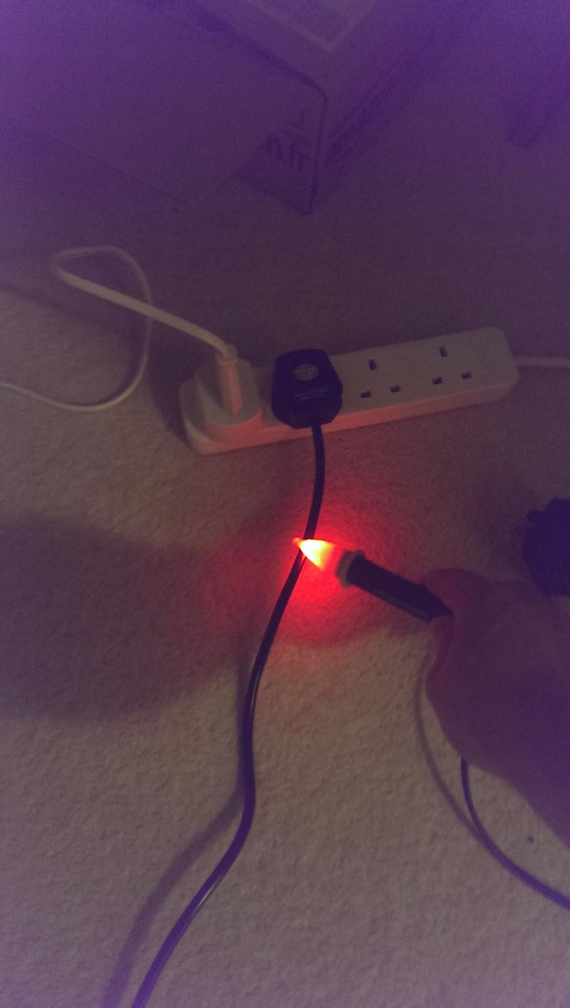

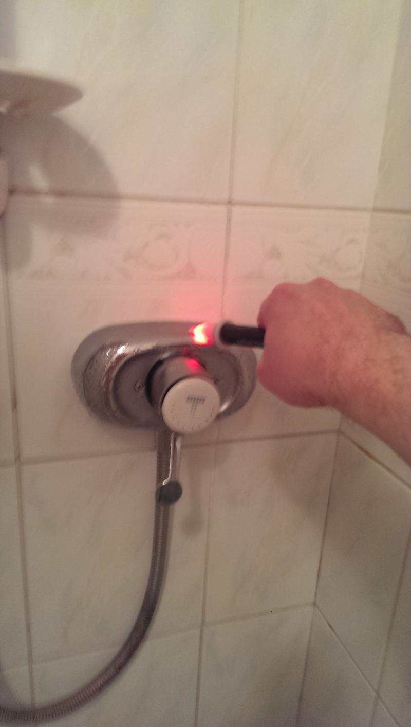

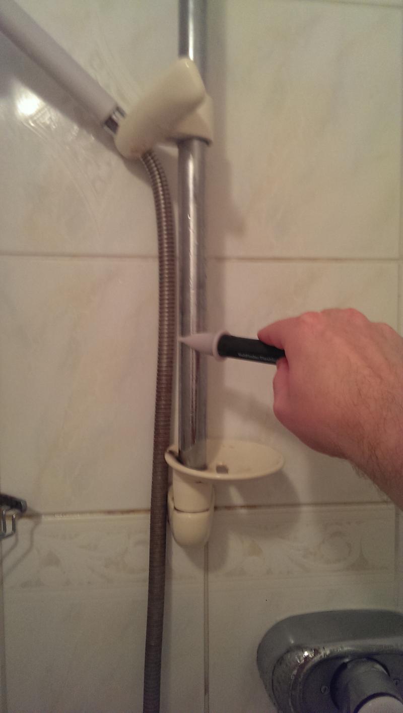

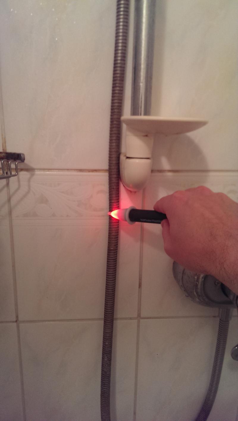

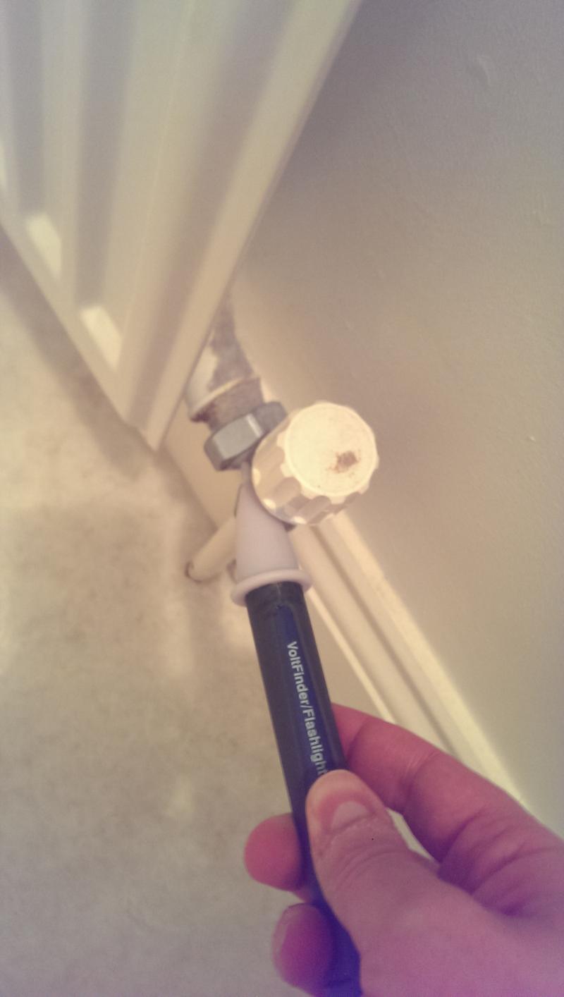

I'll try to be as clear as possible with the following, having been mildly reassured about my misuse of the neon screwdriver in the posts last night, I decided to take my trusty volt pen into the bathroom with me this morning, expecting it to confirm that there is nothing to see.
I've uploaded some photos below just so you can see what I'm doing and that I'm not being a total fantasist :) All photos were taken by me, stood outside the shower, but after using it.
1. Before I got in the shower I used the volt-pen - no indication of voltage.
2. Had a shower, tested with the back of my finger were I have some rough/cut skin - could sense the tingle.
Having been in the shower for a few minutes, grabbed my volt-pen - It lit up red.
3. Finished my shower, got dried, stood outside the shower, used volt-pen again - it lit up red.
4. Checked with the family what was switched on (looking for something
unusual compared to the tests the electrician did yesterday.
5. Very little was switched on that wasn't already on yesterday, but systematically switched off one at a time anything that was on (TV, Kettle, Downstairs light, upstairs lights). This had no effect, the volt pen continued to indicate voltage.
6. All appliance lights etc off, volt pen still lighting up.
7. Got my wife to switch off the upstairs light circuit at the CU - volt pen then is NOT lit, showing that there is NO electricity.
8. Upstairs light circuit switched back on - volt pen lights up.
9. After 10 minutes or so of waiting, put the volt pen against the shower, doesn't light up (check it against a live cable to make sure it hadn't broken in the last 10 minutes also).
10. Run the shower - no indication of electricity.
11. Douse the main shower body/mixer with water - Volt pen now indicates electricity.
Sorry about the long post :)
So, I am back to: There is electricity present, it has something to do with the upstairs lighting circuit and it is ONLY present when the shower is wet, with or without me stood in it.

From what you show, you don't have a "problem" -
you have a potentially SERIOUS problem !!!
I suspect there is the possibility that your lighting circuit earth conductor has been connected to the shower plumbing pipework in the belief that this will act as a bonding feature but neither the shower plumbing nor the lighting CPC are then bonded to the main supply earth point.
Induced voltage from the lighting circuit is then being developed onto the shower plumbing.

When in voltage mode ( touching something metal ) the probe lights up if there is a difference in voltage between the hand holding it and the metal it is touching. It is possible that the pipe is at earth potential and that your body is at a voltage high enought to make the probe light up. This would happen by capacitive coupling between the Live wires in the lighting circuit and your body.
From your description one of the things I would check for is a damp area that has reached an exposed Live wire and thus the damp area is acting as a large capacity plate near near you and thus your body is via this capacitive effect at a voltage high enough to make the probe light when it touches an earthed pipe.
