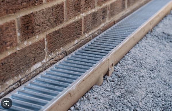

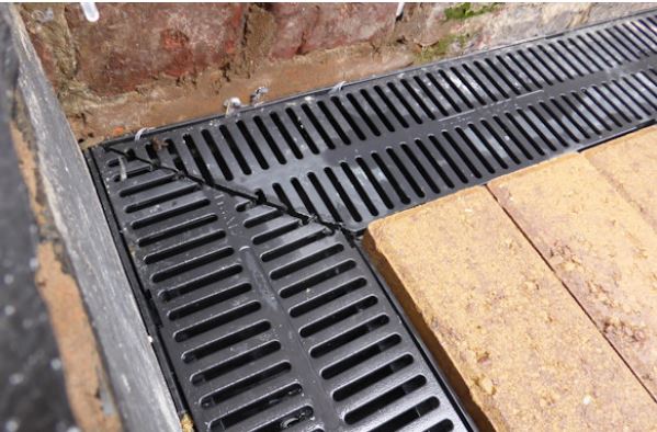

Could you use linear drain in front and along the wall so its all on the surface which would get your depth I think as its not buried as such and you will gain some more drainage to the side too.
