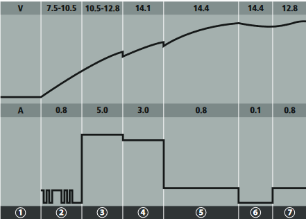

Most are stage chargers and it will have some thing like this
this one it says is 7 stage, but in real terms there are 5 charge rates, under 10.5 volt the pulse charge, in real terms this is normally skipped, it will charge at 5 amp until 12.8 volt, which is still quite a low state of charge, then at 3 amp until 14.1 volt, then 0.8 amp until 14.4 volt and it will then alternate between 0.1 amp and 0.8 amp. The latter Lidi charger shown here does seem to return to the 3 amp charge rate if voltage drops, the old one did not, and the old one would alternate off and 0.1 volt when set for a battery under 12 Ah. Not tested new one.

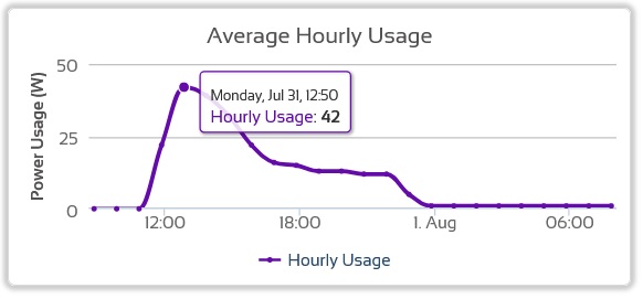

In the car the engine management controls the charge rate, but the big problem is the time taken to recharge. When something like a interior lamp has discharged a battery, I have used my energy monitor to see what is happening to the battery, and one can observe the mark/space ratio between 0.8 and 0.1 amp altering as it charges, the relatively new battery in the Jag when charged over Colvid would slowly increase the 0.1 amp time and decrease the 0.8 amp time until it would lift to 0.8 amp once a day. Always at same time, so clearly some thing in the Jag must turn on at that time.
But from when the LED display showed fully charged to when the 0.8 amp charge rate was just once a day, took some time, maybe a week, so this is the problem with lead acid, with batteries where one could top them up, we traditionally used a equalising charge once every couple of months, without this slowly the performance would drop off.
