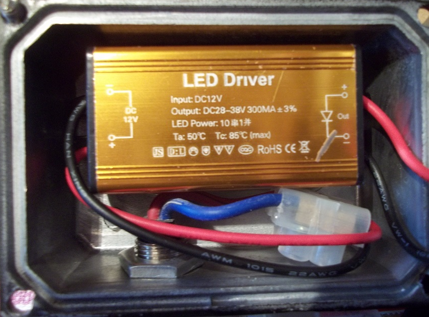

I have installed 8 x 30 watt 12v led floods in my garden which are powered directly from a leisure battery but they don't work??
the cable is 2.0mm twin flat 25 amp rated cable is here (no earth as the lights only have pos and neg for 12v) There is only one independant PIR. The lights themselves do not have a pir. The switch is this one illuminated switch. I have broken my multimeter but have one on order. Cheers

Switch mode drivers controlling the current through the LED element(s) may power up erratically if inrush currents cause significant voltage drops along the cable.
"cycles" of what? This is DC, right?
There won't be a switch mode driver if they're powered from a DC power source.
There will be a driver, Constant 300 mA current output to the LED element(s)
As in this 10 Watt 12 Volt floodlight
