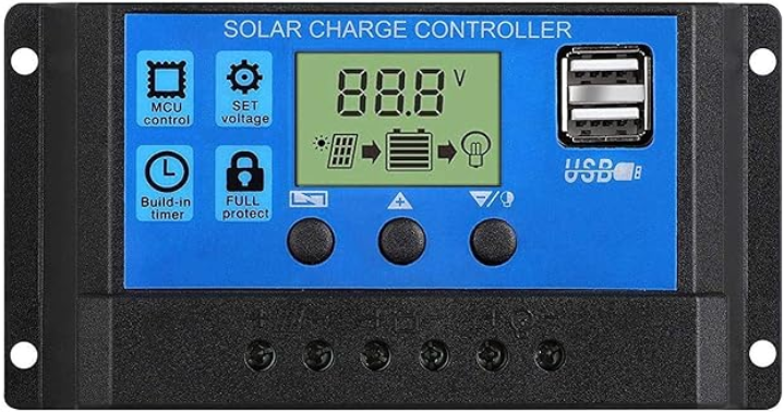

float charged. A typical charge controller View attachment 330286 uses PMW or MPPT charge technology,
That think is junk off of ebay from China and dose not work!
