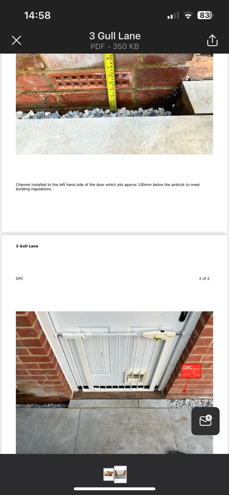

Hi, my son has just had a survey done on a 12 year old house. Survey highlighted the closeness of the air brick to the patio height and raised the issue of splashback from the patio entering the airbrick. Does this look a problem?
issue of splashback.
It is quite common for idiots to raise the height of paving or ground beside a house. There should be a gap of at least two bricks height to the DPC. Sadly there are a lot of idiots about.
Look out for signs of damp or splash reaching or passing the DPC.
Sometimes it helps to dig a trough beside the wall. Cobbles or large pebbles can be put in it, they drain quickly and do not transmit damp by capillarity because the gaps are too big. It should not be filled in with earth or gravel.
Level access happens quite a lot now on new builds.
Just looks like a surveyor pasting in a standard paragraph to ensure you can't sue them.
Take no notice, enjoy your new home.
I'd much prefer to have a step, and add a ramp if I ever needed one.
I guess the argument is that someone in a wheelchair should be able to visit others who aren't disabled without needing to make special arrangements.
I'm still glad to have a step though, in my non-equality old fashioned place.
