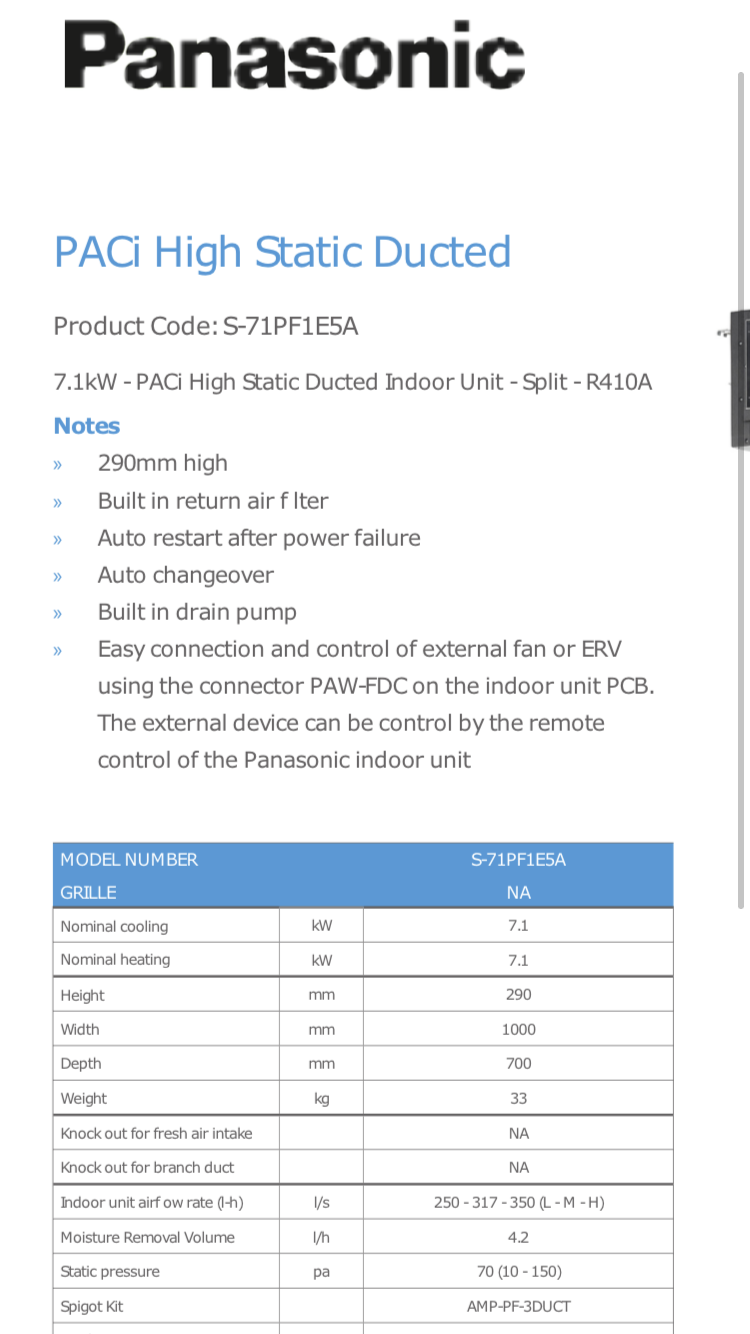

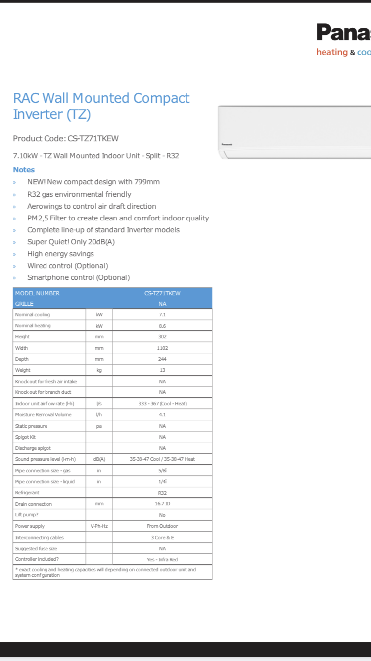

You've not told us the make & model of unit the installation company are proposing to fit so it's impossible to answer your first two questions. As for your third, we know nothing of the insulation levels or even the height of the ceilings, so can't answer that either. Floor area on its own isn't much use I'm afraid

So I have been given two Panasonic options for wall mounted and ducted as per the image specs. Finished ceiling high will be about 2.5m / 2.6m.
