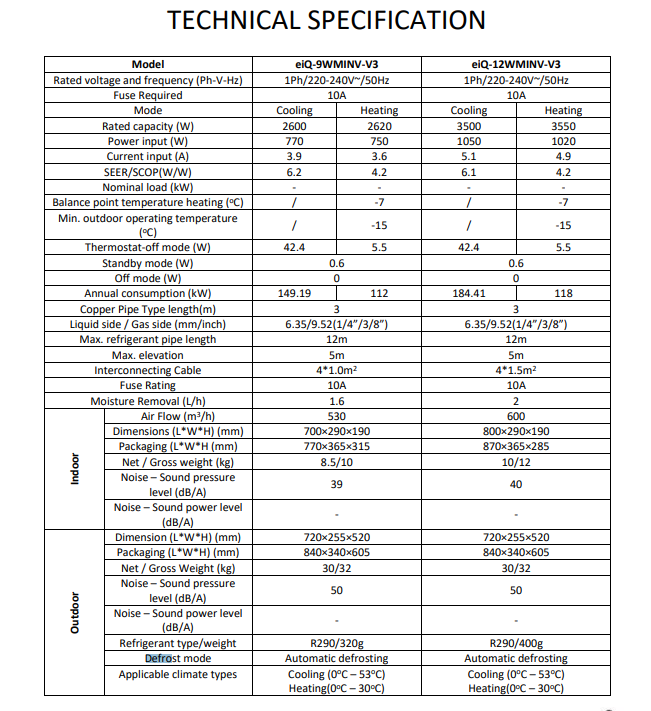

I was thinking of fitting an Electriq Easy Fit split air con system, to cool the upstairs of the house. It uses R290 (propane) refrigerant and so can be DIY fitted.
The main thing that has put me off is the possible running cost when it's sitting unused in winter. The house is heated with a Daikin Altherma 3 split (air to water) heat pump, using R32, and if I switch the heating off when the outside temp is close to freezing the Daikin still uses a load of electricity - I believe it does this to stop the R32 freezing, expanding and cracking the heat pump.
Does anyone know if it would be any different for an R290 based system? Of course, I could keep the Electriq running in heat mode during the winter, and turn down the Daikin. But I want the air con head unit upstairs, which is already warm enough in the winter, so I would just end up with upstairs too warm and downstairs too cold.
My first thought is that the freezing and expansion theory doesn't sound right. Googling shows that the freezing point of the refrigerant is about minus 150 degrees centigrade. And anyway, most liquids contract when they freeze. Also, in heating mode, the coldest bit of the system is the coil in the outside unit. Heat pumps actually defrost by briefly reversing the cycle and going into cooling mode. It's when they are working as an air conditioner that the outside coil gets hot.
I know this doesn't answer your conundum, but it might help you think of different questions to ask. I would contact the manufacturer or an HVAC contractor to get the official answer. Is this the right model? It seems to refer to an automatic defrosting mode. But I have no idea what it does in practice. Also, there may be other forums who do more HVAC stuff.

Now asking the supplier or maker the questions should elicit an answer specific to the units you are considering. (e.g. what is "thermostat-off mode" that uses so much energy cf standby?)
This MSE thread https://forums.moneysavingexpert.com/discussion/6470914/air-source-heat-pump is interesting in that it mentions your model of A-W ASHP as having a standby load of only 15W cf a much older un-named unit taking over 100W (3kWh per day). So do check if there is some other 'vampire load' - such as the legionella cycle occurring too frequently or the 1:1 backup heater being used?
The glossary on another manufacturer (Mitsubishi) website says this:
thermostat-off mode​
means a mode corresponding to the hours with no cooling or heating load whereby the cooling or heating function of the unit is switched on but the unit is not operational as there is no cooling or heating load. This condition is therefore related to outdoor temperatures and not to indoor loads. Cycling on/off in active mode is not considered as thermostat off
standby mode​
means a condition where the equipment (air conditioner or comfort fan) is connected to the mains power source, depends on energy input from the mains power source to work as intended and provides only the following functions, which may persist for an indefinite time: reactivation function, or reactivation function and only an indication of enabled reactivation function, and/or information or status display
reactivation function​
means a function facilitating the activation of other modes, including active mode, by remote switch including remote control, internal sensor, timer to a condition providing additional functions, including the main function
off mode​
is a condition in which the air conditioner or comfort fan is connected to the mains power source and is not providing any function. Also considered as off mode are conditions providing only an indication of off mode condition, as well as conditions providing only functionalities intended to ensure electromagnetic compatibility pursuant to Directive 2004/108/EC of the European Parliament and of the Council [3]
Could the above mean that thermostat-off mode includes the use of the crank case heater and standby doesn't?
Also, why would the thermostat-off mode for cooling be 8x more than for heating?

Well, the back-up heater was something I knew about when I opted for a heat pump. Overall the heat pump cost to run for the 3 years has been similar to a modern gas boiler, with a SCOP of 3.5. In the coldest weather I get a COP of around 2.2, some of which might be from the back-up heater. But with the heat pump switched off in sub-zero temperatures, it seems to use a back-up heater for something (possibly heating the crankcase as suggested above) and I've found consumption is basically the same if leave the heating on but with the flow temperature turned right down - which does at least put some heat into the building. Again, this is only in the very coldest weather, but the consumption is significant. I may be away for a month this coming winter, so instead of turning the heating off, I'll probably leave it on, with the thermostat turned down low and a low flow temp.
Thanks for all your input folks. I googled whether to cut power to an AC in the winter and this https://structuretech.com/ac-breaker-off/ basically answers the question. The consumption will be the crankcase heater and not all ACs have them. If it does, it may or may not be a good idea to cut the power - some AC technicians say you should to save power, others say don't, because it's a common cause of damage.
It looks like the answer is then to get an AC unit that doesn't have a crankcase heater, and cut the power in the winter so it can't run accidentally.
