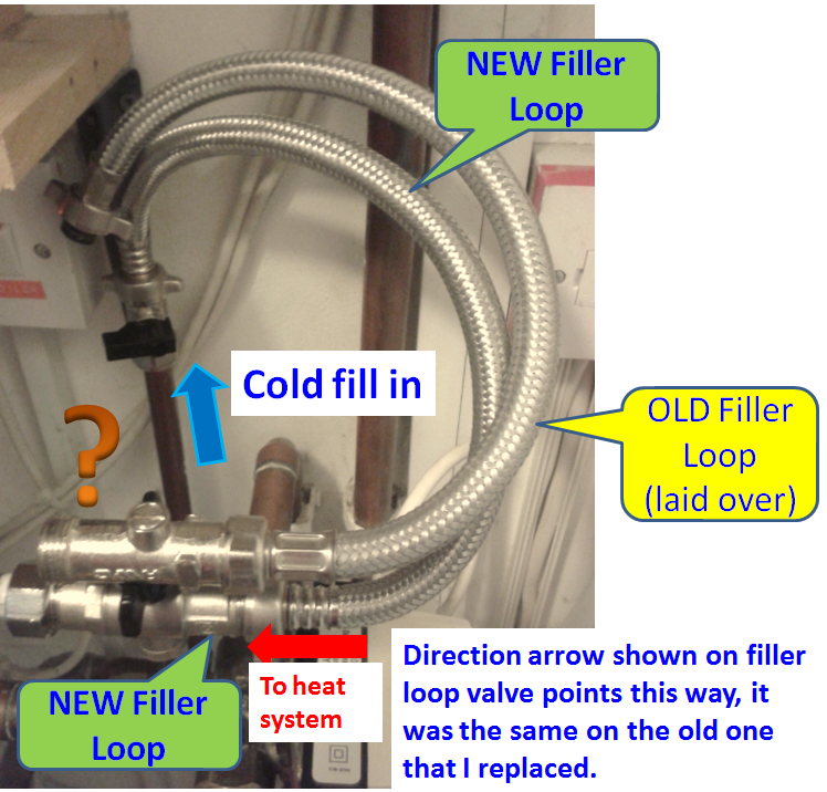

Dan, thanks for the reply.

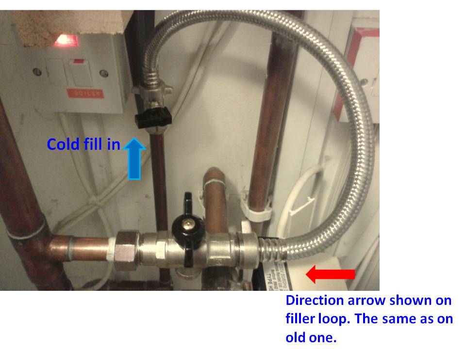

Appreciate your help but if the direction of the new filler loop is wrong, then it was always wrong? Please see photo below and confirm if you still think is the wrong way round.
I replaced like for like and the non-return valve is in the same position and the flow direction arrow is in the same points the same way as the original one.
I'm letting the system settle but for how long? A few hours have passed and the boiler won't even fire up now. Pressure shows 1.8 bar.
Many thanks

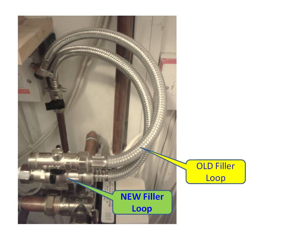

Filler Loop - this loop was really an aside I think, it was the method I had read of for draining off some of the water to reduce the 2+ bar pressure. If you really think it and therefore the non-return valve is on the wrong way round, then so was the old one installed on the system when new 12 years ago by what I understood to be a reputable CORGI installer, local medium sized company who have done good work for the family in the past? But it could be wrong?
>> See my picture of both old and new ones.
But when it's turned off on both service valves it surely shouldn't affect the system with regard to the air in the system? It's just when as I did, tried to drain out some water and it wouldn't flow back because of the non-return valve. So I drained via the radiator drain valve, then I got the current problem with all this air in the system.

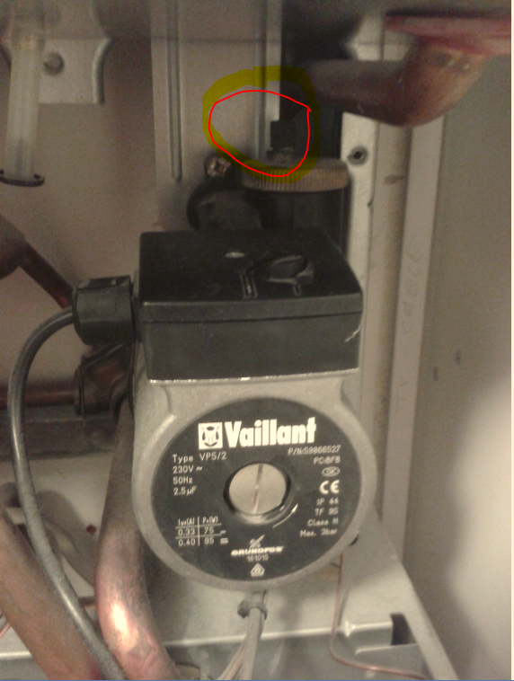

There's an automatic air vent inside the boiler above the pump.
If the cap has been closed you will never get the air out.
On the thermoCOMPACT you can remove the white casing without touching the combustion seals, so will not affect the safety of the thing as long as you don't fiddle.
Simply undo the two screws on the plastic fascia by 90 degs, hinge it down. Then lever the white painted metal case away from the wall at the bottom (there are two spring clips that will let it go), and lift off the upper rear hooks.
You will see the pump at the lower right, with the air vent.
Don't open the metal square combustion box above, you will need an RGI if you touch this (there is no point in opening it anyway).
Refit in reverse.
Thanks very much, I assumed the pump might be running dry by the sound of it.
I have the front panel down and case off, where to now?
See my picture, the pump has a switch/speed selector on top and this cylinder with a black cap on behind it, is it that?
What am I looking for and how do I bleed/release the air?
And is this all with the boiler on or off and room stat triggering the heating or what? Sorry, don't want to make further wrong moves.

Make sure the cap circled isnt screwed down tight, they sometimes leak so people screw them down when all the air is released.
Unscrew (not all the way) and you should hear air hissing out
Thanks again everyone.
Nortonj - I opened the (shut) black cap and air rushed out then stopped with a gurgle, but no leaking water. I suppose if it is a one way auto vent (?) it should just let the air out and stop at that?
Do I now leave it slightly open? Half a turn?
The boiler pressure now shows 1.3 bar.
Can I put the case back now and re close the front - I could probably have accessed that cap without removing the case, but no problem.

> And what about this filling loop? Is it / has it always been the wrong way round? See picture. << someone please confirm, I am confused by this? Doesn't the arrow on these valves indicate the normal low of water?
If the non-return valve is working the wrong way then it will need swapping around. Otherwise it won't protect the clean water supply. And I might need to release more water/pressure in the future and then it won't drain off.
All help very much appreciated.
Would'nt worry about the filling loop, just disconnect hose and cap ends when not using it. Does your boiler not have the purge program (p0)? See M.I.'s on how to do this.
