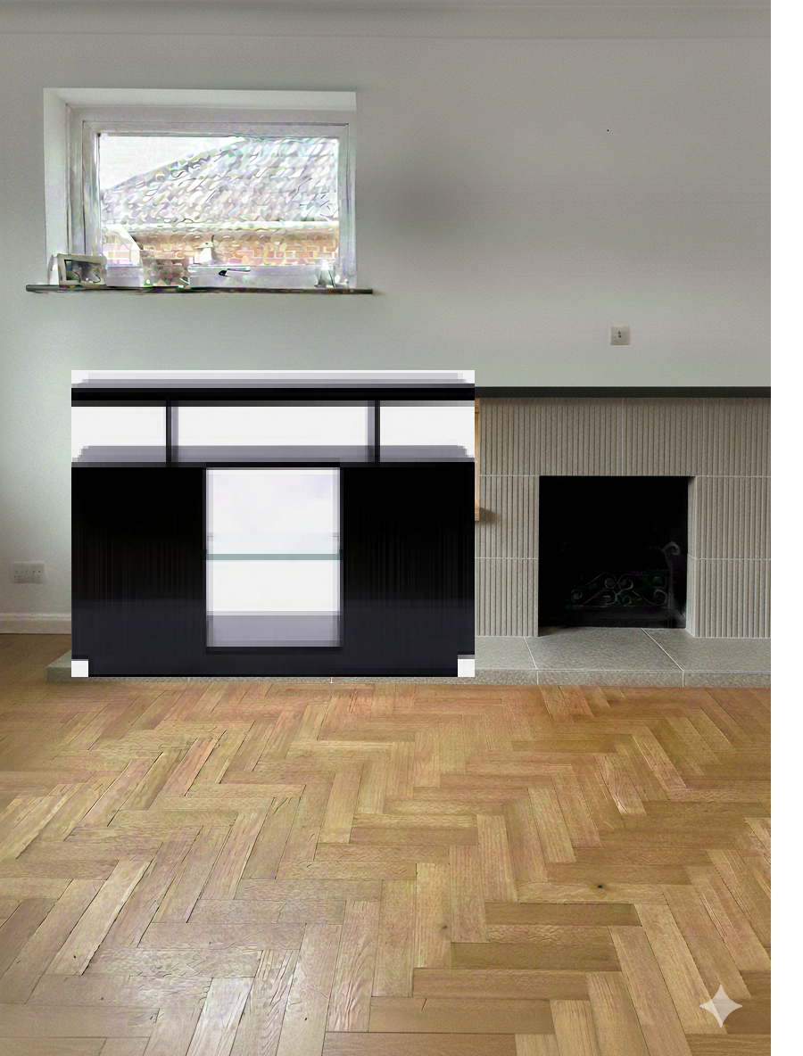

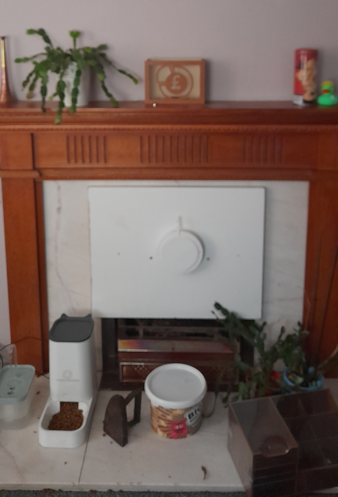

Hi all,
I'm renovating a fireplace in our living room as part of a complete refurb. I've attached a photo of what it looks like now, and an AI generated image of what it will roughly look like when done hopefully. It will be clad in tiles with oak shelving:
My query is how best to install the alcove lighting strip. What I believe I need is some form of concealed compartment somewhere to have power, and store the LED driver. The fluted tiles that I have are actually full height so installing some form of hidden compartment with a removable tile section at the front will break the grout lines. Any suggestions of how best to approach this? It is an external wall.
There's definitely no other way is there, without having some form of void space to have a plug socket and the LED driver? It is only around 170mm deep
I have found, unless you can easily turn it on/off when entering or leaving the room, after 6 months never used. So my lighting is all WiFi connected, so a single voice command can turn it off, this often means it needs a fair bit of space and a socket to supply it. I have the units hidden behind ornaments, but at this stage you can arrange some sort of box to put it all in.
What are you going to do with the openining. You may be able to get a supply from the clock socket and run a cable down into it then through the side to your leds and conceal any controls in the chimney breast.

Good shout. I was going to look at smart lighting options. We have a load of hue stuff so that's the obvious choice. Not sure if they are adjustable length though to fit in that alcove. Will need to check.
I was wondering what that socket was :)
We are probably going to put a fire of some description in it (probably bioethanol)
Leave the timber shelf loose and create a void under it.
I think that is the best potential solution- thanks!
I definitely second this one.
It will make it serviceable.
Additionally I would add, putting the strip in a aluminium channel that can be removed (i like slightly over engineering), as many LEDs will go faulty and start looking untidy.
Out of curiosity, why wouldn't you knock the bricks out from the left of the fireplace and rebuild with a wooden frame, that will create more space (unless you dont need it).

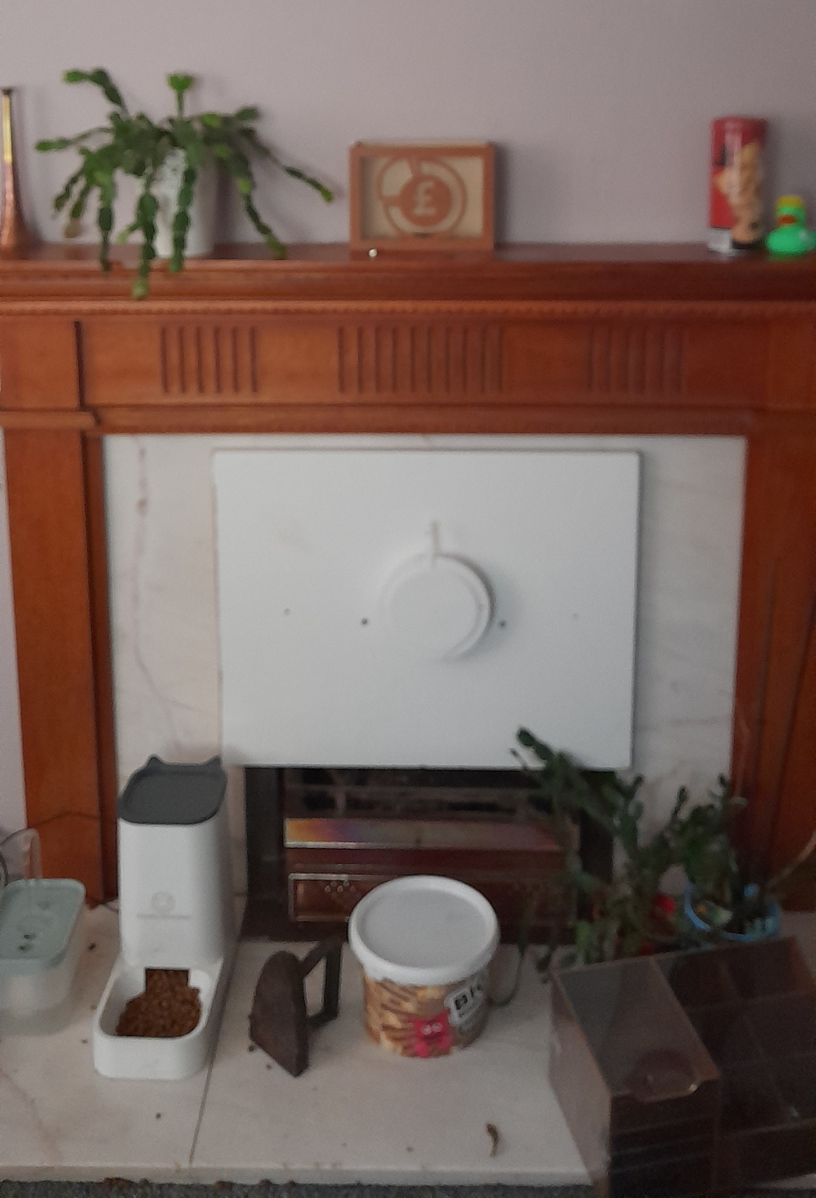

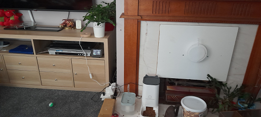

I look at my own 1773931520573.png and I want to improve it. I have never used the grate, it is there for emergency, should I have a problem with the oil fired central heating. The Labour government in 1978-9 resulted in wanting the ability to heat the home without electric. And the chimney is handy to put the AC exhaust up in the summer. But most of the time, not used, so I can see how it would be good to design a fire surround which can be altered quickly and look less utility to my own.
Clearly the chimney and floor vent need to remain, but having something to hide them when not in use seems a good idea. I also want something to the side of the fire place so used an Ikea unit 1773932361008.png it was selected to fit under the TV but keep the TV low enough to be view as a reasonable compromise angle.
I would be looking at something like this 1773932925480.pngwhich will allow you to hide some items behind doors. Well likely keep the existing stone look, would give me a use for my new angle grinder.

Clock sockets had a 1 amp fuse, 13 amp sockets are 13 times bigger, so need to work out what the supply is, maybe from the lights, one can fit grid switch 13 amp sockets with a fuse included, or simply mark socket lights only, can label under plug so only seen when lights are unplugged, but before you use the clock socket, do check what the supply is. The clock sockets today are very expensive, I did like them, but not at today's prices.
