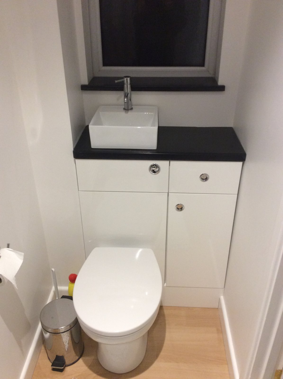

All in one Basin Toilet Unit thoughts
That looks good, what size width is that unit and room? I have a total room width of 800mm so not sure if it will be too tight to fit something like that

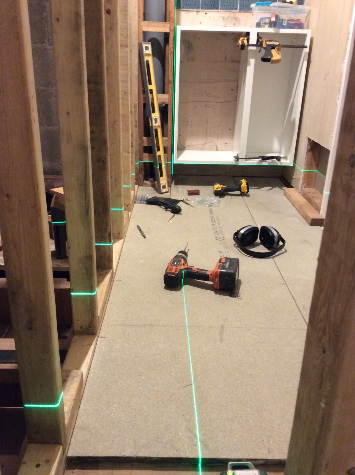

The actual room is 900 mm wide but the space the unts take between the soil stack and wall is 710 mm so is filled with a 400mm unit which houses the cistern and a 300mm one for storage .

Looks really good, which cistern did you use?
Also where did you get the parts from for the unit?

flomasta cistern from screwfix which fills and flushes quietly, the kitchen wall units were carcasses from B Q as were the drawerline door sets.
