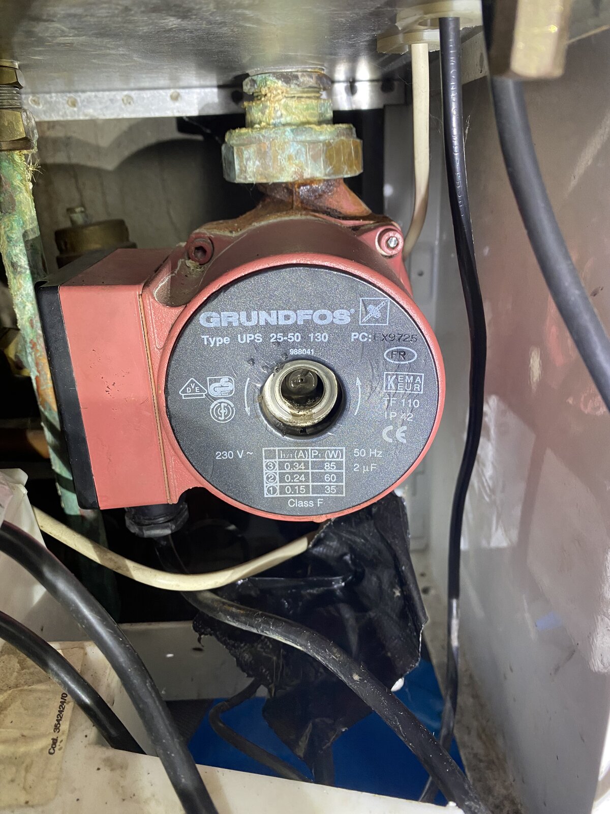

Hi all
Finally getting around to replacing the pump head on Ferroli 701.
Drained down etc.

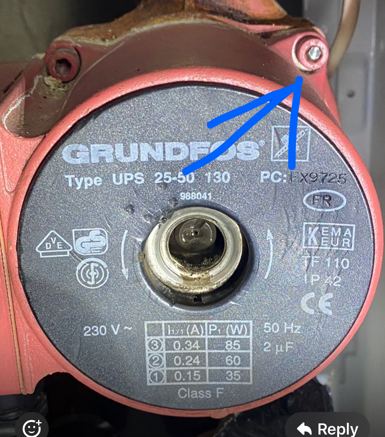

Started to remove the 4 bolts and first one was bit stiff. Had use spanner on end but it loosened.

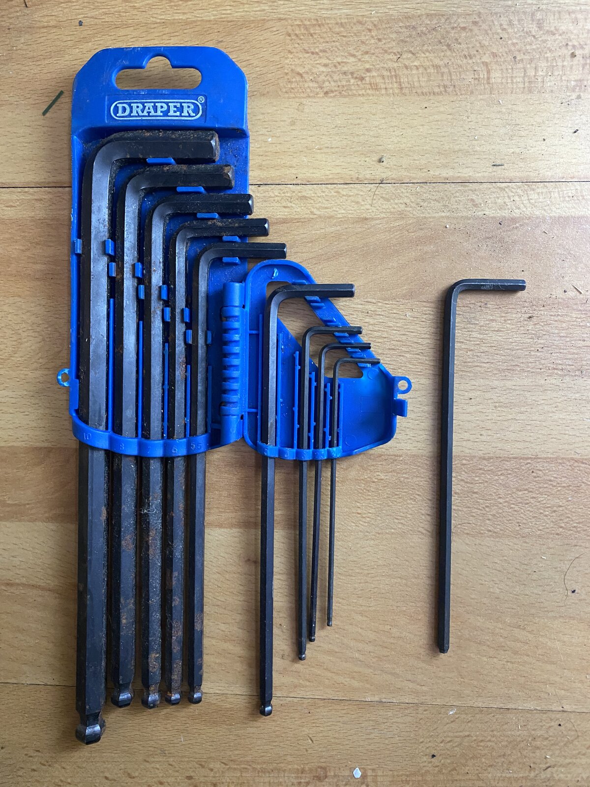

Second one felt same and I presumed I opened /cracked it but my Allen key snapped!!
Anyone had this?
What’s the best way to proceed as I only have the new pump head.
I’m thinking remove the whole thing.
Get it on bench/magne/remove snapped end stuck in bolt.
Then somehow remove them with a stronger 4mm key???
Cheers
As the pump connections have leaked, those steel bolts will have seized pretty solid in that cast housing. You could soak in penetrating oil but even then they may not move.
Yes, getting it onto the bench may help but it will need to be held really securely to work on those bolts. The better tool IMO would be a CV allan set on a socket set TBH. Even then be prepared to get a new housing.
Those bolts, are not usually that tight, my guess would be that your key had a built-in weakness. However, starting to undo a tight bolt, with the weaker, ball end of the key is never a good idea. You should have used the shorter end, with no ball, that way you would have had all the leverage, and less risk of breaking the key.
Likely, the broken tip, is now jammed in the socket - try gently tapping it with a punch, plus hammer, to free it.
File flats on the side of the bolt head. Use adjustable. Be prepared to shear the bolt off in the process!
If you do manage to get the allen key out, try tightening it up a smidge next time, then alternate between loose/ tight, the object is just to get it moving.

I did try the non ball end but no access with long or short keys.

Anyway I managed to get another bolt out with Plus Gas soak and impact on low.
Other two have rounded.
I then had a go at pump.
Got bottom nut free with hammer/chisel to get it moving.
The top one will NOT budge.
I have virtually split the nut open and it moving on the the flanged thread part above.
Need a cuppa and think about ringing few of my mates for a price on a new one.
Arggghhhh!!!
