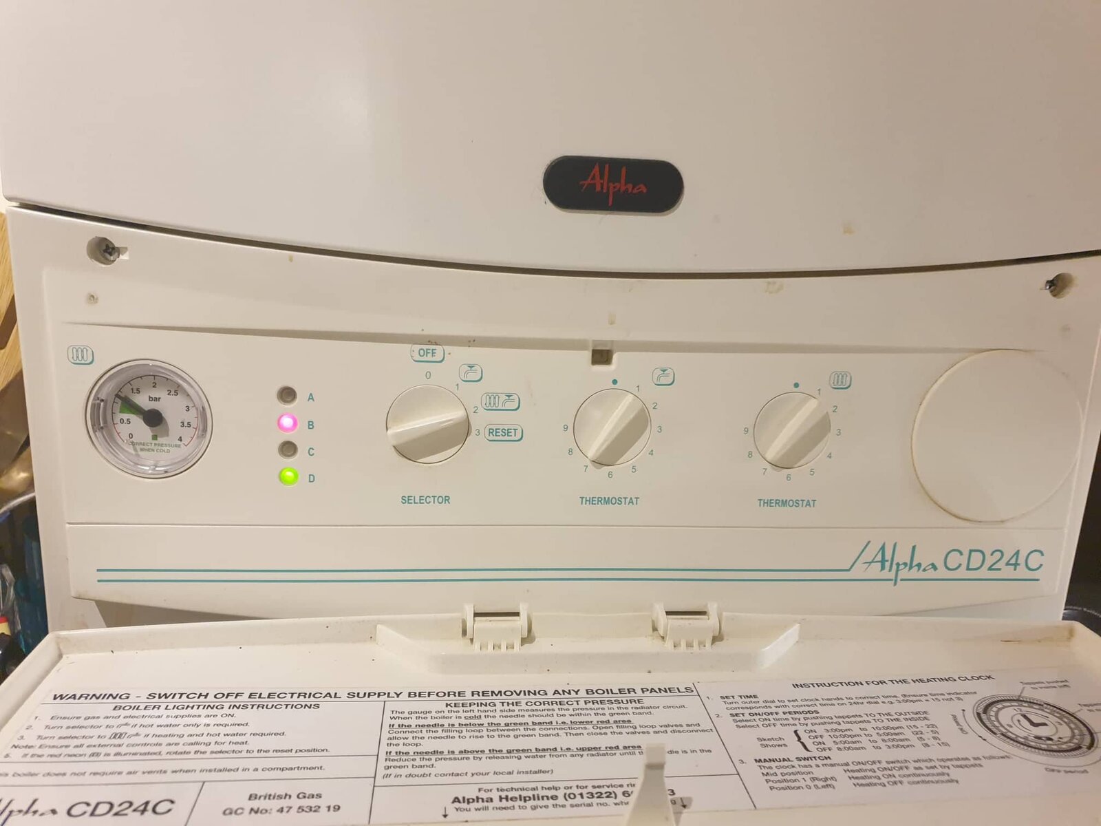

We have an Alpha CD24C combie boiler.....
It was working fine until the RED B indicator started flashing.
I went through the reset procedure and the light stopped flashing but still no hot water.
We now have a constant RED A light?

what is the boiler pressure guage reading, can you post a pic of the control panel on the front of the boiler
I just tried another reset and RED A has now gone off.
Its now trying to fire up (Yellow C comes on) but clicks off after a few seconds.
It keeps trying till eventually it comes up with a solid RED B.
Pressure is in the green area.

Try taking the pressure up to 2 Bar ( you can release this by bleeding a rad ) reset and see what happens, the pressure sensors on these are terrible and sometimes show low water pressure when it isnt
then you need a gas safe engineer now, you have checked everything you can, unless you are holding the reset for more than 2 seconds ,
I had something similar happen to mine only last month and it turned out to be the low pressure sensor was blocked up. Ordered a new one from alpha for about £35 and had it fitted. Old one actually snapped off when they tried to remove it as the thread is plastic so made sure the new one was a brass fitting. Simple for them to test once boiler was opened up
