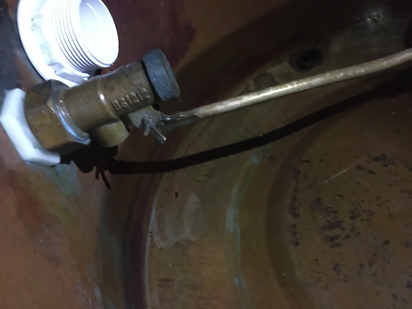

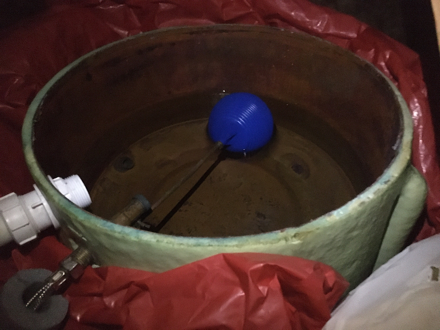

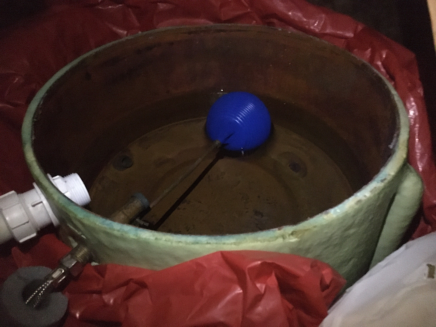

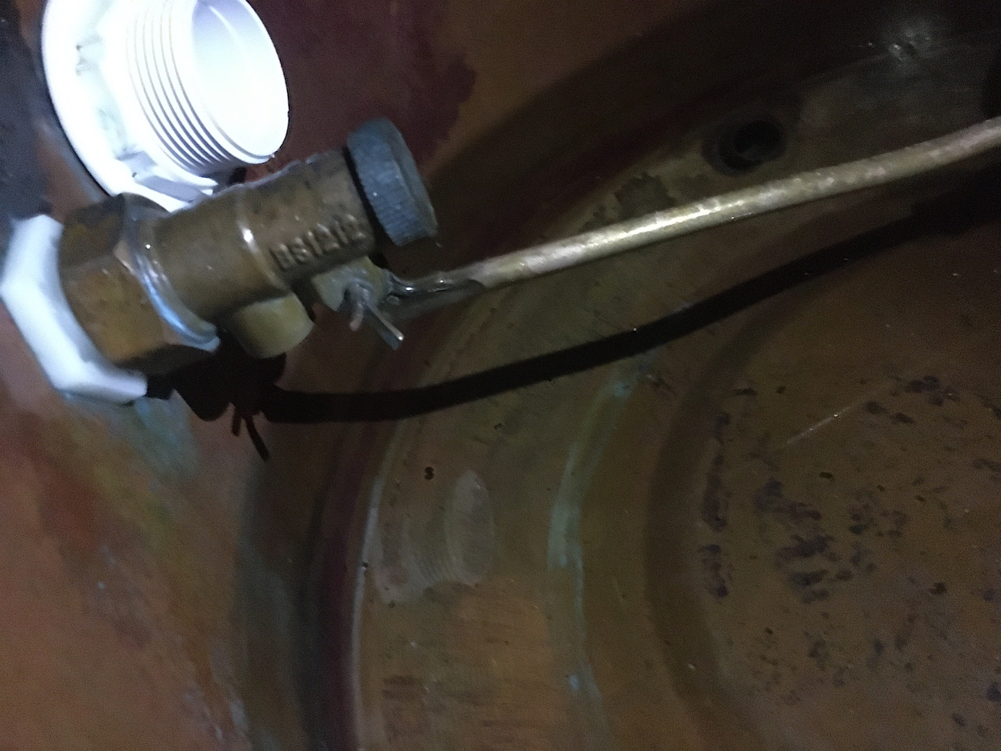

Now I remember seeing it. There is a knurled cap near the ball float. I assume this adjusts the level .
Im oblivious on the physics involved and will definitely try this lowering of the float. How do i lower the float? You mean the ball float thing?
Yep the ball float, you can try just bending it down a bit
Here
Apologies for blurry photos
The knurled knob may be in fact a flow restrictor

Is there an online resource that explains the ball height vs header height ?
It doesnt look like it could go much lower there in all honesty, I'd be surprised if the valve even opens fully when empty. The highest point of the vent pipe is supposed to be 150mm + 40mm per metre of head above the water level. Push the ball down and let a bit of water in, see if anything comes back through the vent pipe.
