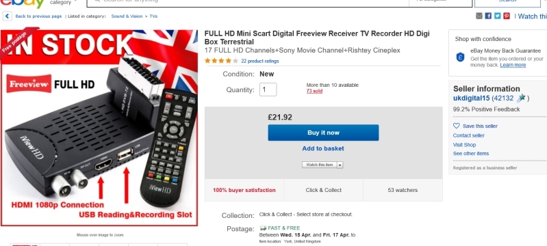

The closest thing I can think of is one of the small Freeview HD receivers that plug directly in to a SCART socket. They're much smaller than a VHS video cassette, and they have a USB port. This would allow you to connect a USB memory stick and so provide a moveable recording solution compatible with older SCART-equipped TVs and that has no moving parts. There is also a HDMI socket which makes the device compatible with non-SCART TVs too.
This is what I'm describing. The listing is from Ebay: item number 132491552173. It's a very comprehensive listing too; lots of pictures of the TV guide and how the device connects etc. There's an aerial connection in and out like a VCR has, so the device can record one channel whilst the TV is being used to watch something else. This records from its own in-built tuner.

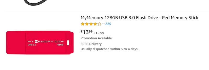

For USB memory, I can thoroughly recommend any capacity of the mymemory brand USB memory sticks. I use one to watch the movies I download on my Panasonic TV. It works great. I have a far more expensive Samsung stick that isn't anywhere near as quick.
This is listed on Amazon.
To recap then, the memory would live permanently with the recorder device. The recorder would be moved between the two TVs. It solves the USB encryption issue and provides a recording solution with no moving parts.

Just had a quick look on e bay and if what they say is correct (This unit records in standard .MTS format which can be played back through most players)
I can buy two, get rid of both video players (Bedroom & Kitchen) and fit these instead. I have plenty of spare memory sticks. Recording looks simple enough but I feel another idiot guide coming on, bless her.
That way she can record or play on either TV and no more interruptions to my viewing to rescue jammed or stuck tapes and an empty draw were she stores her tapes at the moment.
If this works it will be heaven for me, after a few weeks of "I can't do this".
Will investigate this in depth first and probably order one to start with, will let you know how I get on.

It finally arrived this morning (23rd). Easy to set up, the sound and picture quality are great, but need a magnifying glass to read the instructions.
Have only done a quick/short recording using "instant record" with a mixed result.
The recording will play on the LG smart TV (43UM7000PLA) and on one of our two Panasonic Viera TV's as well as on a computor with windows 10, using VLC Media Player. No idea why it wont play on the other Panasonic TV, will investigate further but that is not a problem, it's the LG one we needed it to work on.
The quality of play back is excellent on all machines.
Another positive is that I have been able to remove a Free view box and VCR and replace it with this little thing, so much tidier.
Need more time to "play" with it but the initial results seem to solve our problem, Just need to teach my wife how to and that's another story :-).
Thanks Lucid, your a star.
Further update:-
A 16GB memory stick records just over 7 Hours of viewing.
Hand book, if you can read it, is incorrect, best to find your own way round the recording feature. Deposited this it is a good buy.
I don’t understand any of that but I’ve ordered one of those 128Gb sticks to try out on my telly.
If you use a 128GB stick, based on my experience with a 16GB stick on this recorder. I would estimate that you will be able to record somewhere in the region of 56 hours of normal television (not HD programs) before the 128GB stick would be full up.
Hope that helps.
