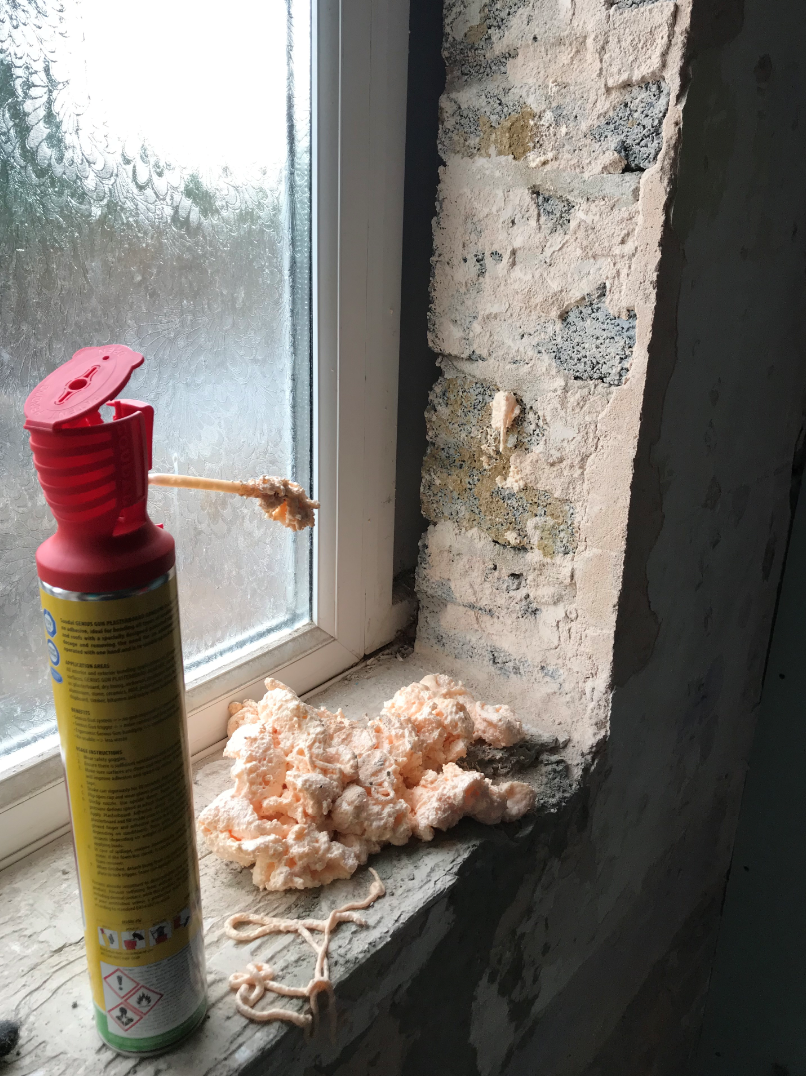

I need to stick on a couple of plasterboard pieces around the window reveals and want to avoid having to purchase a full bag of plasterboard adhesive. Is there an alternative adhesive I can use to create the dot and dab affect?
The surface will then be tiled.
Grab adhesive, or most other plaster like bonding
Or expanding foam
Might work, might fail, wouldn’t recommend it but might get lucky
I used this stuff today but without any success....
I first used it on the board and then straight on the wall. Here's the end result:
Also, as seen above, I need this plasterboard to come around 50mm away from the wall. Is there a product other than regular plasterboard adhesive that I can use for this please?

They’re not the same, but it can be used. I’d not do a whole wall with it, but have used it for smaller areas, in your case it will be fine. Although, if you’re trying to dub it out a lot, the dri wall adhesive is easier to work with and a bit “stickier”.
Yeah you can, and I said that in my first reply to you above... (y) but if you’re trying to dub it out a lot from the wall, that won’t work so well, your better off dabbing.
Batten it out and screw the board to the battens. I'm surprised the foam didn't stick, especially if you damped down the surfaces first - I've stuck plasterboard to plywood (at the top of a window reveal) and it was rock solid.
