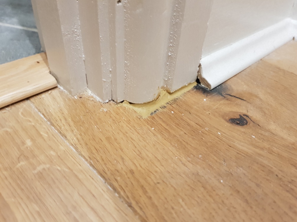

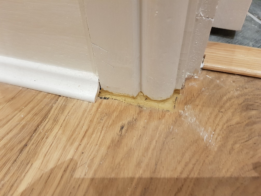

We're very nearly at the end of a very tiresome refurb of our downstairs area. As you can see from the photos, our builder has used Silicon wood filler where the floor meets the door-frame and his reasoning is that any hard (setting type) wood filler would crack as you go through a year with the changes in humidity as the floor moves.
I think it looks horrendous and I'm not happy with it. Does anyone have any suggestions as to what can make it look better?

I wonder if the scotia trim should be take off and a longer one put on that has a little mitred return. A bit of the torus architrave will need cutting back to scribe to the scotia. Unfortunately flooring or laminate never looks that good if the skirtings arent removed since the scotia always has this problem where it meest the architraves. I wouldve taken off the skirting
The obvious immediate answer is that the oak flooring would normally run under the architrave, but it isnt always possible to actually get under if the board goes to the other side of the room.
Retro-fit an Architrave base block? that would take care of the Architrave.
Yes plinth blocks ,thicker than the skirtings ,to architraves (skirtings but up to side of plinth blocks).
Plinth blocks now otherwise rip the floor up and undercut the architrave and door frame and slide the laminate further under, any decent floor fitter would do this, is this the first floor your builder has ever fitted, he hasn't even returned the mitre at the end of the beading, poor quality install in my opinion

Getting plinth blocks fitted seems to be the nicest fix as it would hopefully look nice without looking like a bodge.
How would you go about fitting plinth blocks without having to remove the doorframe, skirting board and scotia trim?

Careful use of a multi tool would sort it.
A plinth block is an option -probably a block with chamfers on it would work.

Ok so they would need to cut the architrave out at the bottom to the same or slightly higher height of the skirting board and essentially that bit replaced with a plinth block which would butt up to the remaining architrave, skirting and scotia trim?
Plinth blocks higher than skirting ,at least 150mm high ,projecting 20mm past outside of architrave , chamfered on front top and side edges.
