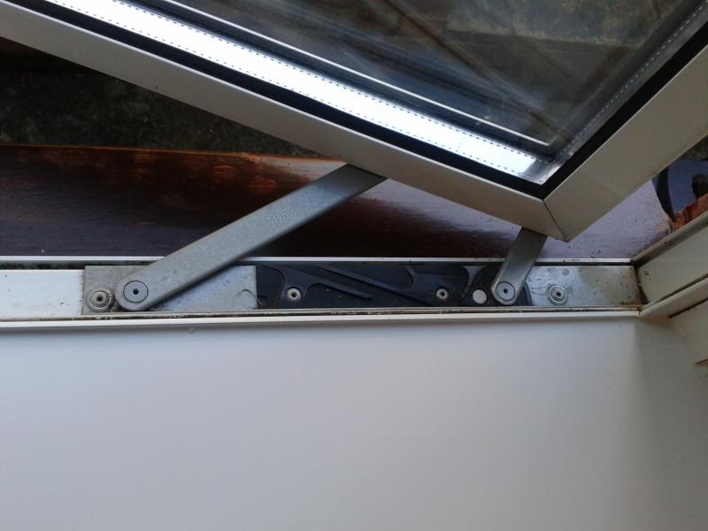

Most of the windows are failing due to a 5mm gap due to the hinges. I could looking at the hinges replaced.... (but they are non-standard riveted one.... )

Firstly - Just because the hinges are rivetted , doesn't mean they can't be changed...

Can you post a pic of your hinges? As said just because they are riveted does not necessarily make them much harder to change.

As for hinges, here are a couple of photos I found on this forum. I believe they are Shaw 305S.
I am worried about calling in a double glazing repair guy and he removes the hinges and can't get alternative hinges to close the windows properly.....
full
full
//www.diynot.com/diy/threads/hinge-for-aluminium-window-shaw-305s.424074/
They don't say which exact hinge they replaced them with....
