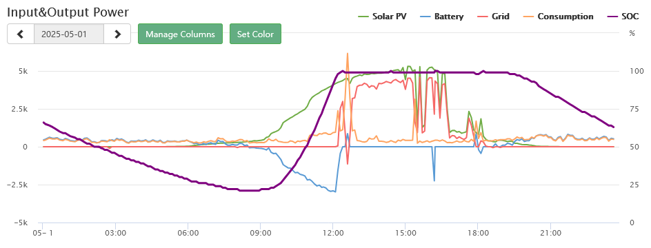

As you say, the car charging and solar are the problem. Rest could stay at single phase. However, in my own 5 kW system, the idea is to not use the grid as a battery. I don't want to feed into grid at 2 pm, and then run the house off grid at 2 am. That will happen in the winter, but in summer I want the battery to bridge the gap when solar is not producing.
So I see the purple line dip at 9 am, and by 12:20 my battery is full, and I am exporting until 7:30 pm, hard enough to ensure the dishwasher, washing machine and tumble drier run when I have loads of solar with single phase, to ensure it runs for free with three-phase, would be even harder.
Why anyone would want 17 kW I don't know, but per phase it is only 5.6 kW only a little larger than my own, and using the shower I still import, so unless all shared between phases, it would still mean winter they would be importing.
