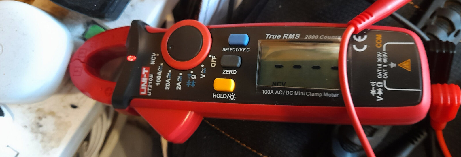

I tried to measure DC with my own house, and found the zeroing of the clamp on means to measure 6 mA is not easy, with the AC scale measuring the leakage in mA to ensure under 9 mA not a problem, but DC seems a little hit and miss.
