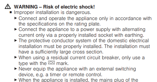

Bosch washing machine requires Type A:
Interestingly, it does not seem to actually 'require' an RCD at all - merely saying "When using a residual current circuit breaker, only use...."
The bolier instructions are also interesting, since (per what I recently mentioned), the recommendation seems to be for an RCD which will respond to DC "(fault)" currents.
Kind Regards, John

However, at least in the case of the washing machine, it could be that what is being said is that, if/when the WM (and other things) are protected by an RCD, then that RCD should be a Type A, to avoid the risk of the protection (by the RCD) of other things being impaired by the presence of the WM?
Remember that, as I said, the WM instructions said nothing about an RCD being 'required' - it merely indicated what type should be used IF one had one.
