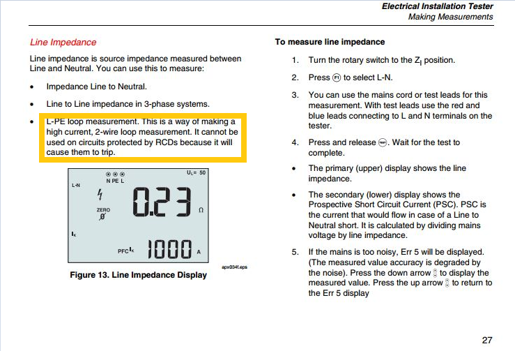

So just tested the Megger 1552 on No-Trip Zs. As I suspected, with both the N&PE leads connected to the CPC and nothing to N, the RCD tripped and the tester displayed TRP.
Once it displays TRP it stops testing, regardless of whether or not there is still voltage present between CPC+Line

Page 27 contains only notes relating to the instruction given on Page 26, the first of which is:
Turn the rotary switch to the  position. The LCD indicates that the high current loop mode is selected by displaying the  symbol.
That first placeholder (relating to a high current loop test symbol) refers to a position of the rotary switch which doesn't exist on my 1652 (either of my 1652s!). Does the switch on yours have such a position?

Surprising it doesn't have a hi-current test, can this not be done using the F1 button or whichever that button to the left of the LCD that changes RCD test mode etc?
On the Fluke, F1 changes between 3 wire and 2 wire.
2 wire is high current, 3 wire is not.
The display shows 2 wire as dots in only the N&L indicators, nothing in PE.
The two leads in the N&L sockets are either connected to L&N, L&E or between 2 phases depending on what you want to measure.
Yes, it can, and EFLI is looking at a version of the manual which explains this more clearly. The F1 button toggles between "L-PE" and "L-N" loop testing, and I have always just thought of it as such. However, what I should have realised (and what EFLI's manual, but not mine, explains) is that one can do an "L-N" loop test ('2-wire') between L and PE. I would have thought that they could have made the display (and buttons) a bit more explicit about this .... but, anyway, one learns something every day!

On the Fluke, F1 changes between 3 wire and 2 wire. 2 wire is high current, 3 wire is not. The display shows 2 wire as dots in only the N&L indicators, nothing in PE. The two leads in the N&L sockets are either connected to L&N, L&E or between 2 phases depending on what you want to measure.
Yes, I now realise that - see my response to Iggifer. Partially because of the manual I've got, and partially through not having thought about it, I have always taken that functionality as being what it says - toggling between L-N and L-PE loop tests. I probably should have thought of it, but it never occurred to me to do a "L-N" loop impedance test (since that's what it says in the display) between L and PE!

<page 27 of his Fluke manual>
See my respopnses to Iggifer and flameport. I think I now understand what has confused me - I have a manual which covers several different models, but yours is presumably just for the 1652. It's a bit naughty the way they've written mine but it does not really talk about doing a 2-wire high current EFLI test in "L-N" loop impedance mode, since, instead, (and without saying so) they talk about a different model which has a (rotary) switch position for the 2-wire EFLI test (which the 1652 doesn't have).
