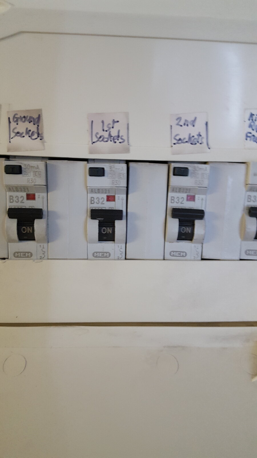

For anyone not familiar, the Memshield 2 RCBO is assembled, in the factory or in the field, by snapping an RCD pod onto a MCB. They are made to fit together, and this enables a very wide range of options to be built.
I seem to recall, that they have pulsating DC protection, but do not seem to be listed on a search of "Eaton" and I don't have the technical literature from the time.
I found a spec of the MR30 on a distributors website that says "tripping class A" which is what we now prefer.

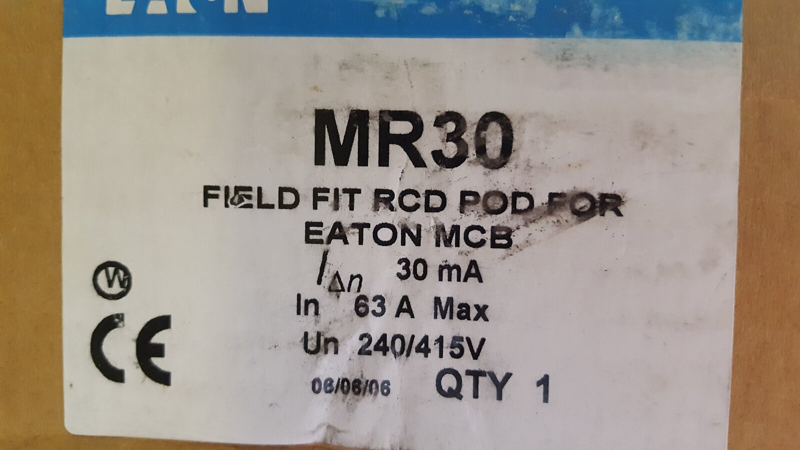

Can we have a pic John (focuses around the test buttons) , The ones I found online were indeed type A, however I do wonder if all of them were, the Mem2 range was current from 1997 up until 2009, and I's say a type A rcbo in the 1990s would have been unusual but not impossible
I looked at adverts and technical spec for a MK 10 mA RCD socket outlet, and there is nothing to say type A or AC, but it does say AC and pulsing DC so one would assume type A.
I note many adverts now refer to curve B not type B when referring to MCB's, but not all, I still have the paper work for my RCBO's, it states "Tripping Curve B, C. Residual Operating Current (IΔn) 30 mA it includes the test procedure.

What do you make of that?

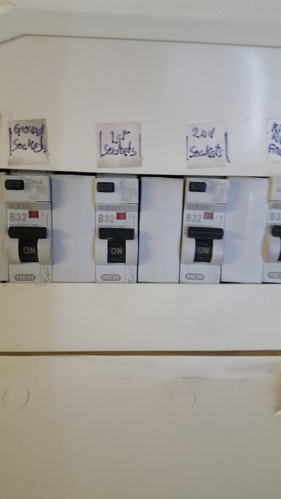

The only indication anywhere on the RCBO to show it was not type B as written on the box was a very small logo with just a single sine wave depicting type AC on the paper work it calls it curve B, C on the box it was written type B.
I looked on the screwfix web site to see what type A RCD's and RCBO's were available. For RCBO's it does not say what type, the BG picture shows it is type AC, the Wilex picture shows it is type A, MK picture shows type AC, Eaton picture shows type AC, Schneider picture shows type A, but the description does not actually say what they are, you have to enlarge the picture to find out.

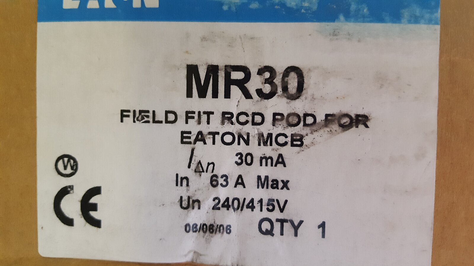

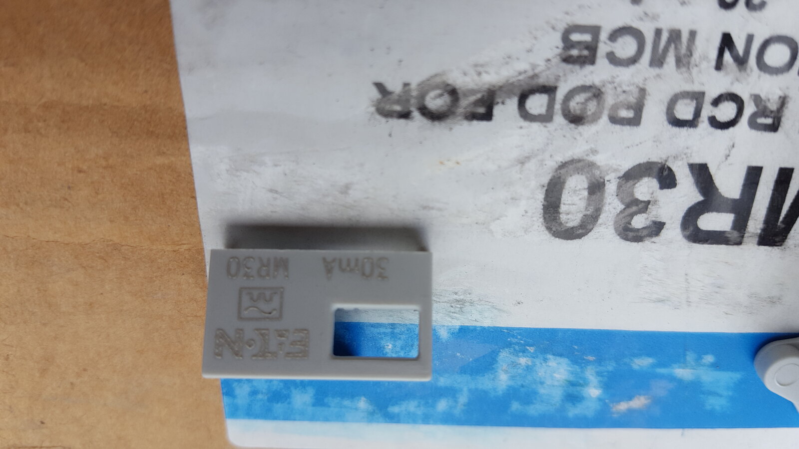

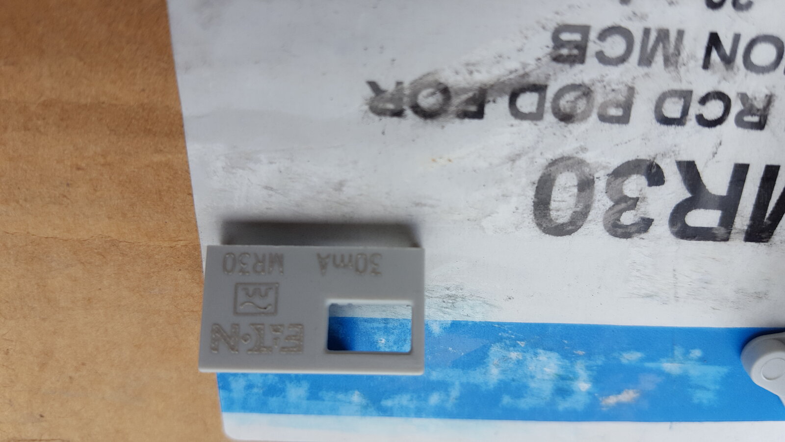

Ah, I see what you're looking for now.
Yes, conveniently printed, very tiny, in mid-grey on the light-grey plastic, both the AC Sine wave and the pulsating DC gappy teeth are shown.
There is nothing else on the box label, or printed on the device itself, to indicate.
I don't know if "E1" or "R30" are significant.
Curiously, although I see that Memshield (edit - sorry - Memera) RCBOs are only about £30, they are a later (German?) design, and AC, whereas the MR30 pods, to the old MEM design, are "A" and around £100.

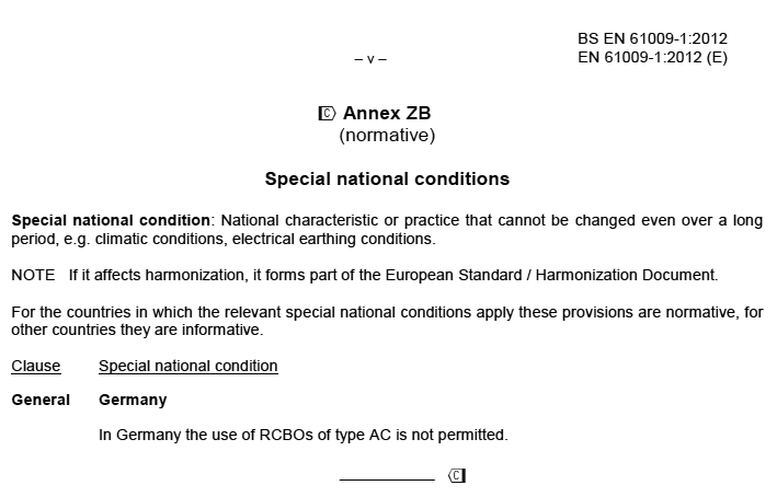

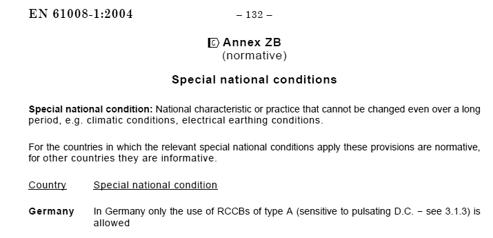

That's correct, but it would only apply to RCBOs / RCDs used in Germany. nothing to stop German companies making type AC provided they were used elsewhere.
The standard for RCBOs (61009) and RCDs (61008) allows the use of Type AC, but has a special note for Germany where type AC is not permitted.
