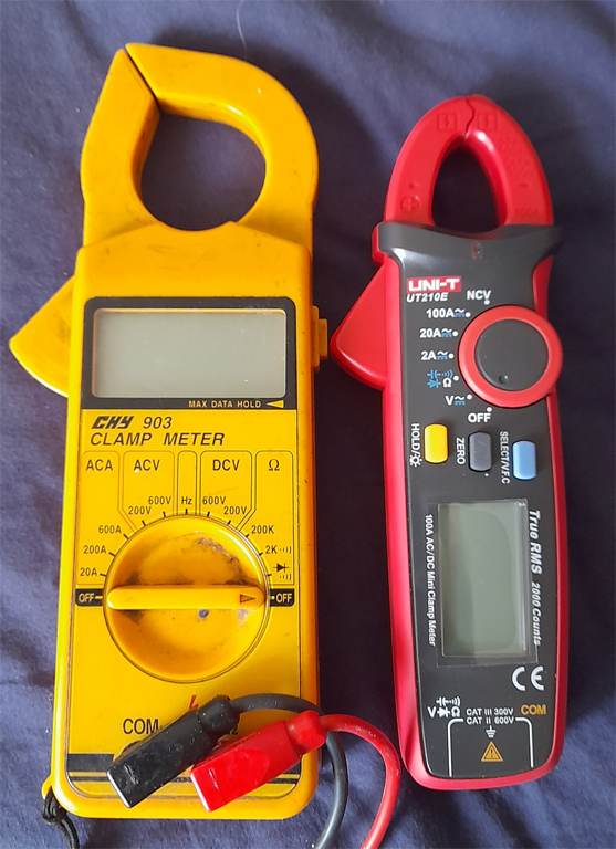

I have had a clamp on multi meter for years, but only one decimal point and only AC. 1663423977553.png So at long last I have a meter to measure mA and DC. So testing measured the charge rate on battery charger, and combined neutral and line incomers and DC at incomer.
Leakage seems between 18 mA and 21 mA but this is all 14 RCBO's so seems OK, and DC component shows as around 10 mA higher than expected. Battery charger was as expected so readings seem to be within what is expected, but other than leakage normally less than 30 mA as above that would trip a RCD in a home with only two, I have never before actually measured it.
I did find on DC range important to select range and press zero first, but with meters I have used in the past one started to get a knowledge of what to expect, so when you saw 1M Ω even if a pass, you know that is rather low, and one looks at why, same doing earth rods, expect a single rod around 60 Ω so if you read 2 Ω one looks for a water or gas pipe not disconnected for the test.
So want to know what is a normal reading, I would have said over 9 mA leakage the supply needs splitting into multi RCD's but only test in past was if the RCD tester tripped at ½ rated current I assumed some thing wrong.

Yes, and you must hold it near the wires to be clamped in the orientation it is going to be used and not rotate it after zeroing.

.... at long last I have a meter to measure mA and DC. .... Leakage seems between 18 mA and 21 mA but this is all 14 RCBO's so seems OK, and DC component shows as around 10 mA higher than expected.
I've only ever used such things to measure currents which were essentially 'pure AC' or 'pure DC'. Does the spec/documentation of yours say anything about the accuracy of (either) reading when both AC and DC components are present - i.e. does the presence of a DC component affect the accuracy of displayed AC current, or the presence of an AC component affect the accuracy of displayed DC current?

I have not fully read the instructions, however I did note on battery charger no reading until DC selected, and it defaults to AC so move the range change and you go to AC on the current ranges, not really bothered reading voltage or ohms or frequency yet I have had a meter which could measure them for years, as seen on left of picture.
It will just about take the two singles for total house supply, so can now read down to 1 mA earth leakage, it is a large house, three floors, but I had not expected such a high reading, since spread over 14 RCBO's not a problem, but not what I expected.

What is the make/model of your meter?
Following my earlier comments, I had a look around to see what the documentation of 'mA clamp meters' (often described as 'leakage meters/testers') had to say about the accuracy of low DC current measurements in the presence of AC components. However, (albeit perhaps because I am incompetent at searching!) not only have I not yet managed to find that, but I haven't actually yet found a clamp meter (even very expensive ones) which claims to be able to measure very small (handfuls of mA) DC currents at all, let alone in the presence of AC components! Am I missing lots of things?
Kind Regards, John
This is the advert the manual I have found here it was the cheapest one I could find, so likely not that accurate. But far better than what it replaces.
Thanks. That one certainly seems to claim to have 1 mA resolution for DC (clamp) current measurement (presumably "down to 1 mA"?) - which, as I said, was something I had not found in my searching. However, it says nothing which addresses the question I asked - i.e. how the measurement of very small DC currents may be affected by concurrent AC components in the current.
It seems a very reasonable (perhaps 'too low'?) price, so I might even get one and 'do some experiments' in order to get some sort of answer to my question!
