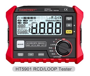

In the past, my meters measured in 100's of an Ω, so would look at say 0.35Ω they could be turned to amps and read the PSCC, sometimes they would assume 230 volts, so 0.35Ω = 230/0.35 = 5.6kA.
But my cheap new meter only measures in 10's of an Ω, so showing 0.3Ω and 0.01 V this does not seem to make sense. Is the 0.01 volt the voltage difference between on and off load test? Set for a 30 mA RCD then 9 mA is the maximum leakage, so I know many testers are designed to draw 9 mA but however I try to work it out, can't see how 0.01 volts = 0.30 Ω.
RCD tester works well, and 0.30 Ω seems about right, but what do the volts refer to?
the 0.01 V likely represents the voltage drop corresponding to the test current (33.3 mA) across the 0.30 ohm resistance.

Only for my own testing, and for me 0.3Ω is close enough, but default is volts, and can't work our what the 0.01 volt refers to.
Sat there with Excel trying figures against the reading, 0.01/0.3 = 33 mA but why would I want that reading?
Idea it to check the loop impedance is low enough to add to the circuit and it does that. And also ensure the RCD is within limits, and it does that. It is far better to the cheap version 1735522846428.pngat about the same price Loop impedance tester.jpgand 0.1 Ω increments has to be better than 1.9 Ω as the lowest reading.

Same here. However, if you are measuring an impedance (EFLI) then if (for goodness knows what reason!) the device displays a voltage as well as the impedance, I think I would simply ignore the voltage, no matter what it relates to!

Fair enough,but if it's clear in indicating that the impedance being measured (and if that 'loop[ impedance' is what you want to measure) is displayed as 0.3 Ω, then anything else it displays is surely irrelevant, isn't it?
If, having got a figure for the ;op impedance you want, PFC (PEFC or PSCC, depending on what 'loop impedance'i being measured could then be calculated by some very trivial arithmetic on your part.
