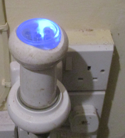

You can expect a £2 battery light to have batteries replaced and maintained.
A light hooked up to the mains maybe ok
You can expect a £2 battery light to have batteries replaced and maintained. A light hooked up to the mains maybe ok
I'm not totally sure what you're saying. I was talking about ones like the below, of which I have several. They obviously have to be 'hooked up to the mains' if they are going to know when there is a power failure, and the (constantly trickle charged) batteries in mine generally last for years.
Kind Regards, John
