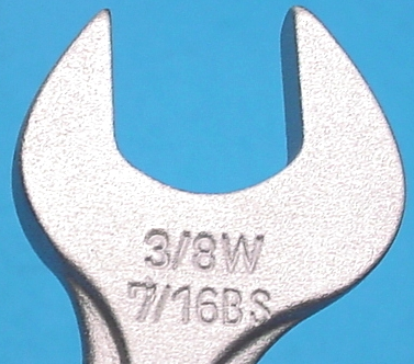

The width across flats indicates the "size" of the spanner. It is imprinted on the spanners in millimeter (mm) values. Older British and current US spanners (wrenches) have inch sizes that are imprinted in intermediate sizes in fractions.
the head size does not always relate to thread size, some of the old British the nut and bolt had different spanner sizes. Also duel marked upload_2022-3-4_1-26-12.png Whitworth and British Standard. There were some odd sizes, like 1 1/16" which really was a mm size. Today we even get metric moving spanners upload_2022-3-4_1-36-39.png .[/quote][/quote]

spanner sizes
the head size does not always relate to thread size, some of the old British the nut and bolt had different spanner sizes. Also duel marked View attachment 262954 Whitworth and British Standard. There were some odd sizes, like 1 1/16" which really was a mm size. Today we even get metric moving spanners View attachment 262955 .

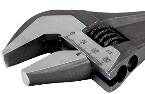

In Germany adjustable spanners were and maybe still are referred to as being Ein Englander
An adjustable wrench (Verstellschlüssel) is called an Englishman (or person, if you prefer). According to Wikipedia (g), this is either because the first such wrench was patented in England, or because when German workmen encountered English nuts and bolts measured in inches, the adjustable wrench was the fastest and cheapest way to handle them.
