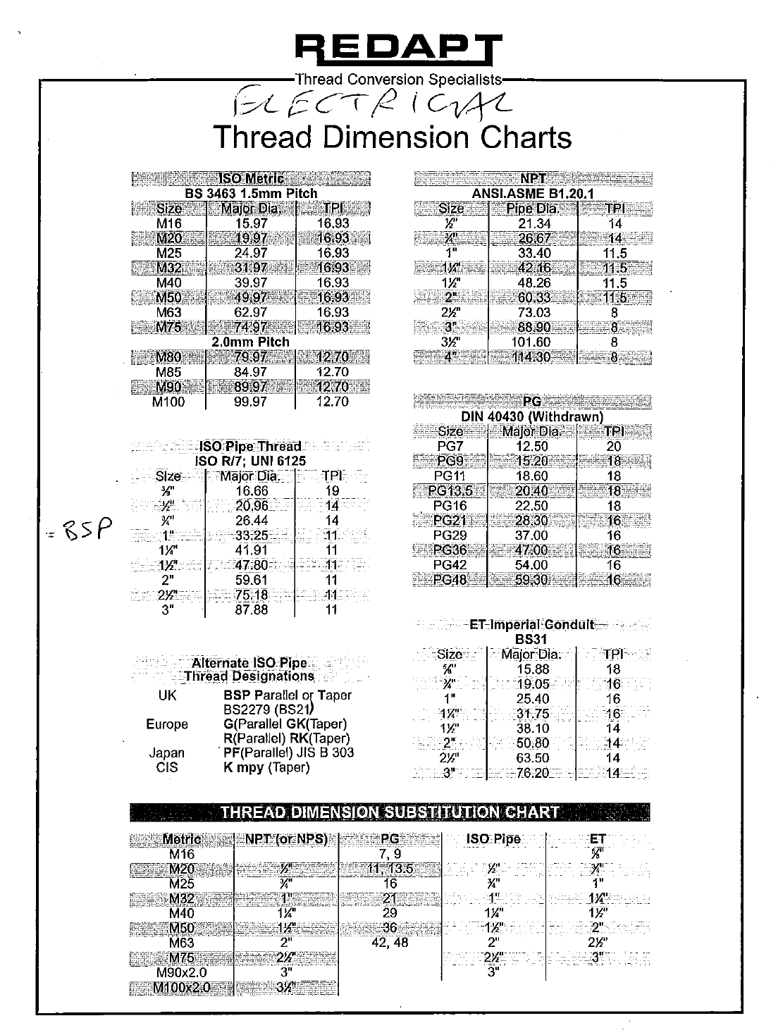

As this is the electrical section I'm surprised it's mostly about bolt threads. Electrical threads used to be eg PG7, PG21. PG for Panzer Gewinde (Panzer thread, but why I don't know) till superseded by metric electrical (not the same as metric bolt threads, obviously)

As this is the electrical section I'm surprised it's mostly about bolt threads. Electrical threads used to be eg PG7, PG21. PG for Panzer Gewinde (Panzer thread, but why I don't know) till superseded by metric electrical (not the same as metric bolt threads, obviously) ... And there's plenty of other threads out there.
I must say I've never heard of PG threads - my 'distant past' recollections of electrical accessories (in the UK) are all of BA threads.
What do you mean by "... metric electrical (not the same as metric bolt threads, obviously) ..."? What is a "metric electrical thread"? Is, for example, the (electrically) ubiquitous 3.5mm thread any different from that of an M3.5 bolt?

Here's a chart with various threads. I haven't worked on this sort of thing for some years so a bit rusty! I think metric electrical (and earlier PG) threads were for cable glands, conduits etc. The thread pitch, and some of the diameters are quite different from metric bolts. AFAIK BA (British Association) was another bolt thread to add to BSW, BSF, UNC, UNF etc. Thankfully it's pretty much disappeared now.

PG threads are far from withdrawn.
To come back to this, the electrical threads I was referring to were for things with a hole like conduits, with minimum OD (for PG7) 12.5mm. I assume 3.5mm dia is for things like threaded studs for spade connections. Do you have a spec for them? I don't think it's the same as a metric bolt, as 3.5mm is not a standard diameter. Bolt standards are M1.6, M2, M2.5, M3, M4, M5, M6, M8 ...etc.
