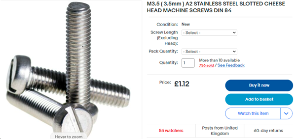

I don't know about that, but what I was talking about are the M3.5 machine screws used to attach the front plates of virtually all standard UK electrical accessories, hence with countless examples in every UK building (hence very 'ubiquitous'!).
Do you have a spec for them? I don't think it's the same as a metric bolt, as 3.5mm is not a standard diameter. Bolt standards are M1.6, M2, M2.5, M3, M4, M5, M6, M8 ...etc.
I don't have a spec. Maybe not a 'standard diameter,' and certainly only commonly seen in the electrical context, but they do exist more generally, as in ...

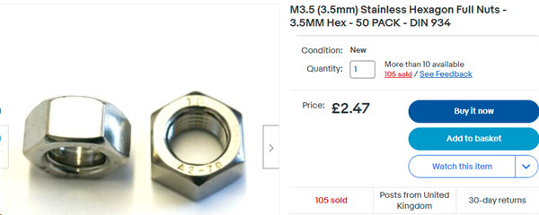

OK thanks, interesting. There's nothing about electrical on those screws, so looks to me like they're ordinary metric, and M3.5 is non-standard. From the web, for all sizes, the pitch agrees. As far as I can tell, DIN 84 is the spec for the cheese head.
You're welcome. However, what I illustrated was far from alone. A search on Google or eBay etc. for "M3.5" gets many thousands of hits, but something like 95% of them explicitly relate to "electrical screws". However, the other 5% or whatever is still quite a substantial number, and they look like the one I showed - seeming just a 'non-electrical' M3.5 bolt/screw, even if that is a 'non-standard' size. The 'electrical' ones certainly don't have cheese heads.
Yes, since you had asked about a spec, I Googled that, and came to the same conclusion as you.

Beyond that, they are simply M3.5 machine screws - but I don't think I've ever seen an M3.5 nut.
