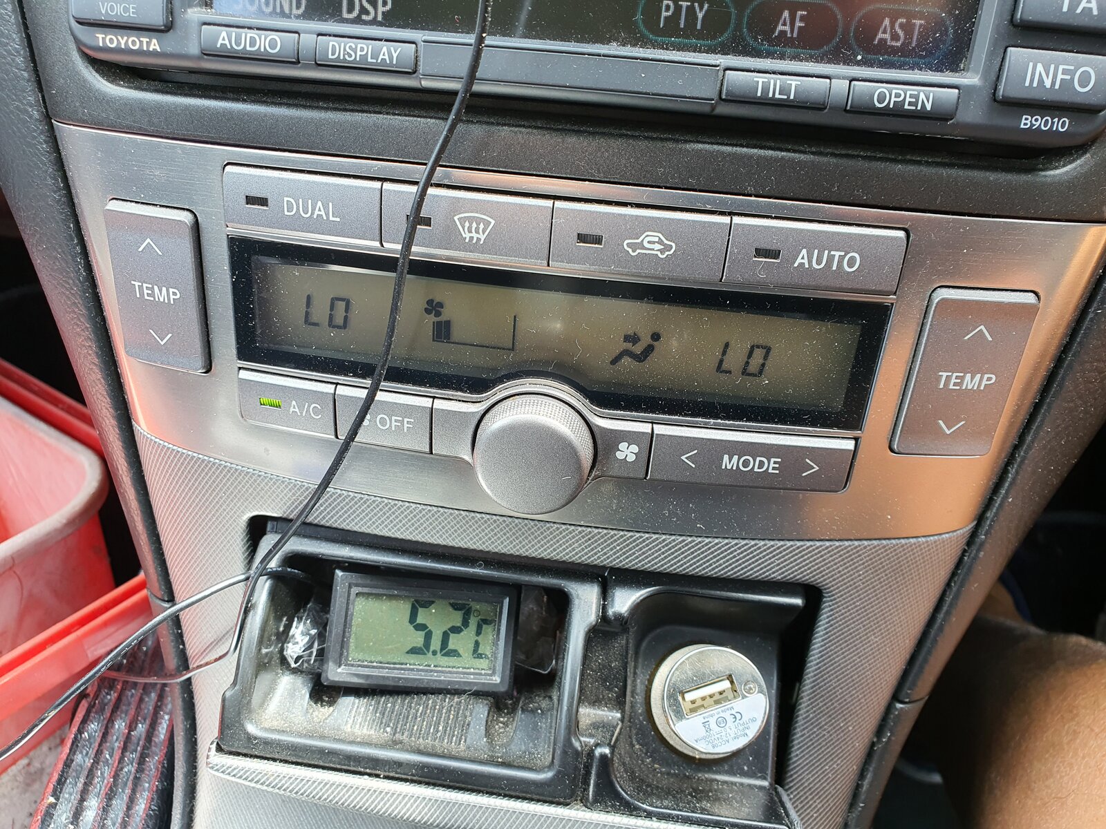

Everything is easily replaceable except the aircon re-gassing.
Just buy a can of gas from Halfords and do it yourself.
I used a can to recharge mine after doing a pipe repair two and a half years ago.
The thermometer in the ashtray is showing that it's blowing air at 5.2°C.
That picture was taken three weeks ago.
