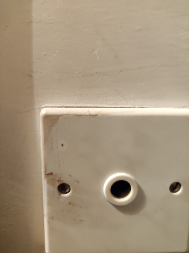

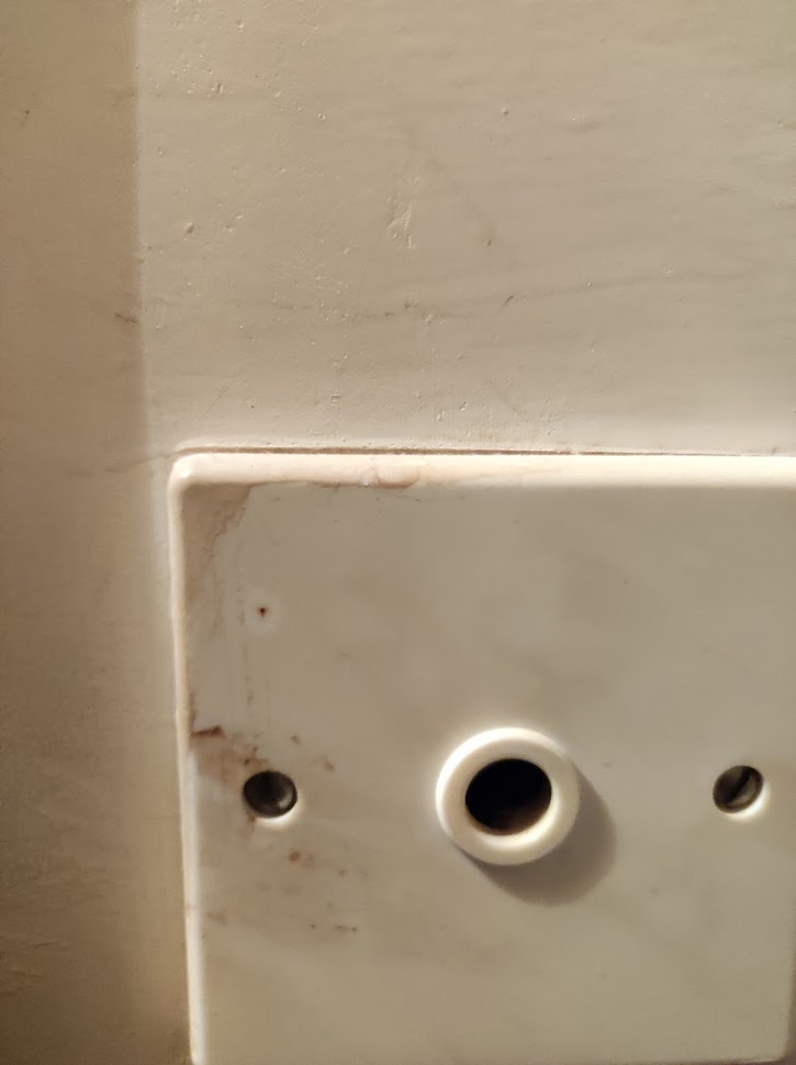

Ok i just had another look in the airing cupboard (which isnt exactly above the breast but is almost above it) - the airing cupboard is where i have a combi boiler and there is some obsolete piping going into the loft (tank was drained by plumber who put combi in but left in situ)
I found this on the opposite wall. Looks like it has take a bit of a knock! is this it? I shone a light in the hole and can see a green and red cable.
They should need to be used for the purpose, but it might have been a flex outlet to the flex for an immersion heater. Turn all the power to the house off, undo the screws and take a look/phone of the cable inside. Post on here, before refitting and turning the power back on.
I will do that tomorrow when it is light, but hopefully this is the mystery solved
I have a laundry basket in there, and this was very close to the floor- i didnt even know it was there, will have a closer look tomorrow thanks.
While doing that, how is the current boiler powered?
Possibly some chance its a fused switch and behind the plate there may be a disused cable?

Waved a wand at my live sockets then waved it at my ancient cabling, pronounced it dead, went into the airing cupboard etc to 'just be safe; and opened up the flex socket which was dead and also had a quick look at my wiring and bonding- tidied up the cabling for me too behind the fire
Told me i would need a condition report but he doesnt think i would need a rewire based on what he has seen it wont be an issue
