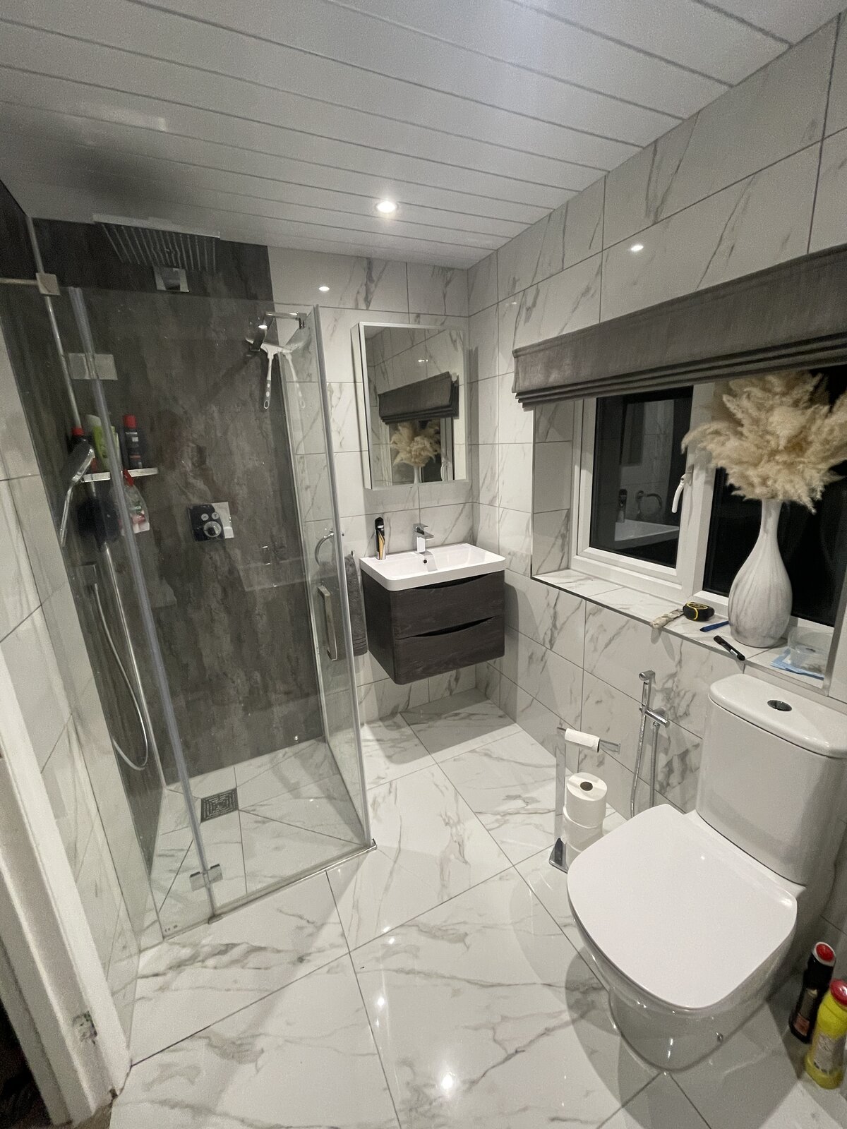

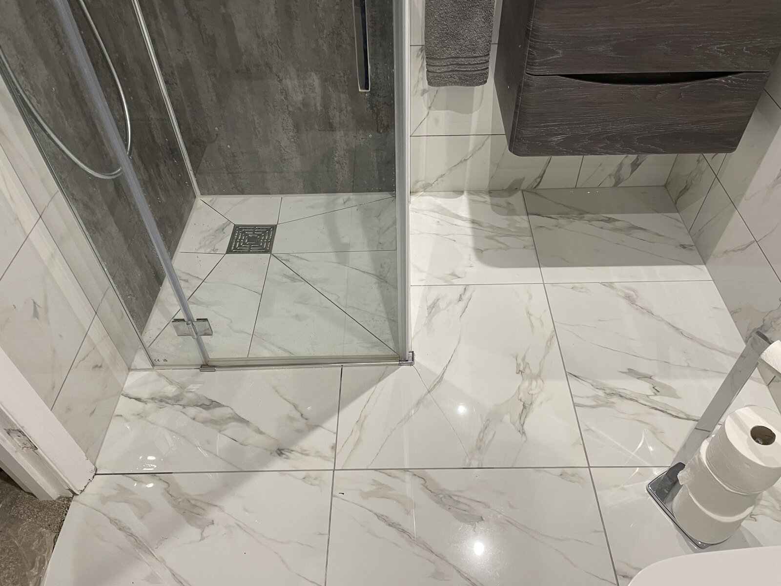

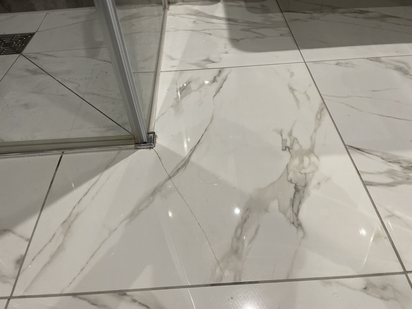

Hi all, I have almost completed my bathroom project, which has been a complete back to bare brick renovation. New plumbing, sub floor, electrics, everything. It's fIrst bathroom I've ever done, and the first time I have ever tiled and I'm really pleased with the result other than this one cracked tile. You'll notice that I've done a wet room style floor in my shower, but the pattern is just in that space, and the rest of the floor tiles are laid around that. The tiles in the shower are non-slip, where as the rest of the room they aren't. The tile that has cracked is notched, an L shape if you like, so I've obviously created a weak spot in the corner where I cut it. It has a 18mm plywood floor, then a 6mm tile backer board underneath, and I used S1 flexible adhesive. My plan is to remove the shower screen, and pull up the broken tile. I have access to engineering materials and a lazer cutter, so I was going to remove the backer board, and replace it with a 6mm steel plate, as I think I just might get this problem again. And when I cut the new tile, don't cut it to a point, try and put a radius there so it not a weak spot (or as weak) for a crack to form. Does this sound like a reasonable plan ? And if anyone has any tips how to pull the tile up WITHOUT damaging the surrounding tiles I would appreciate the help. Many thanks. ANDY
