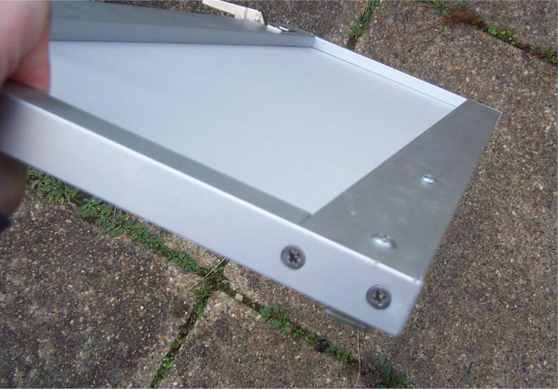

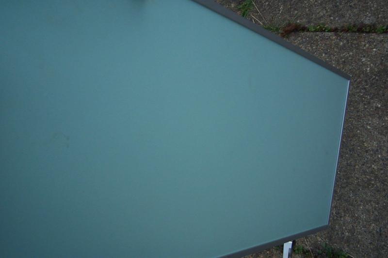

Does anyone know of an online supplier who stocks a comprehensive selection of sizes and finishes of ali angle?* I have to do a blue peter job on some kitchen drawer fronts. The rest of the doors and drawers are made from an anodised aluminium frame, with an inset melamine/formica panel. However there are 2 drawer fronts that are the same colour as the rest of the kitchen, but are your standard particle board jobbies without any ali frame. I need to create the effect of the existing, by fixing lengths of 20mmx10mm angle to the edges.
The units came from an local shop, that discontinued this particular range, and since closed down.
BnQ do this, but in slightly different dims, I assume that routering this stuff would reveal a shiny edge beneath the surface finish?
*(Or better still does anyone know of a kitchen manufacturer who uses this aluminium surround?)
Deluks - try Blackburns (used to be called Baco Metal Centre) just across the border in Edenbridge. They do some anodised stuff but not sure of your profile. Consider making from untreated then get it anodised ... loads of anodising firms around.
Trouble with buying it pre annodised is any cutting you do obviously wont be annodised.
Best bet is to buy what you need (Blackburns / Aalco) and have it annodised when you have cut / drilled it.
A1 anodising in crawley is one of the best local ones
