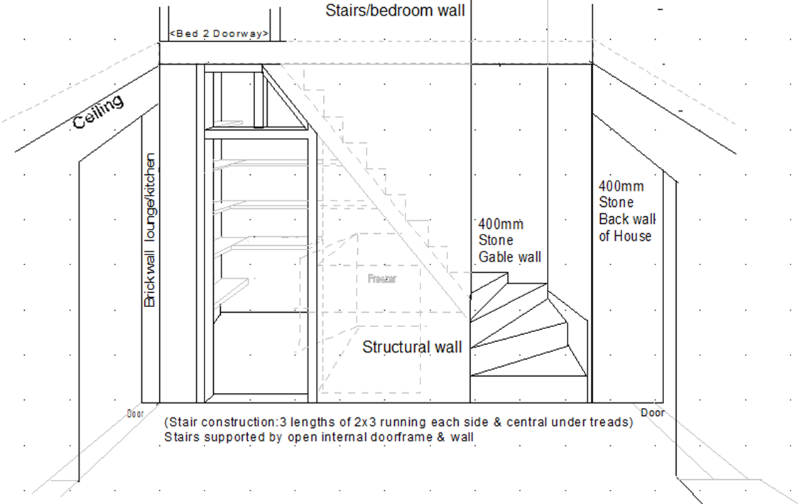

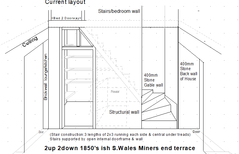

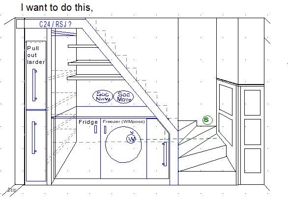

Is my drawing realistic with what has to happen? (Drawing to scale dots = 1foot)
My building experience is limited to timber structures - I'm assuming i need an RSJ if there are bricks above? not C24 (new bits shown in blue)
What dimensions of I beam do i need, 6"? I'm assuming it will rest on the solid dividing wall?
More importantly how much does it cost to get one made?
Are they commonly bolted together or is it cheaper to get it cut and welded in the 2 angles?
Who does this in south wales? No fabricator was specific - only about new build/knock through modifications or per m etc.

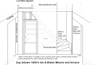

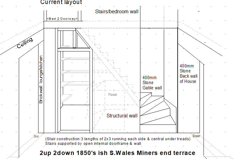

2 photos showing my plans and current layout.
Space is not abundant, I need freezer and WM in the kitchen, larder & worktop space - i.e. I don't want a central 4" pillar under top of the stairs.

Can i sit the beam under the stair treads adjacent or sistered to to the wooden central and edge stringers instead of resting them on it to keep some extra height on the diagonal? With solid plastered wall i can't see how the stairs are attached on the kitchen side - assuming they are not hung as you might nowadays. The stairs and layout are original and open into kitchen and there are fire doors on the bedrooms for fire regs.

You need to get this moved to the building section (I think you "report post" and the mods will move).
I can't quite fathom out what's going on, but if your plan is to remove most of the masonry wall below the first floor you would normally insert a straight steel at first floor level to support the remaining wall above. But there are cheaper alternatives such as removing the upper section of the wall as well and replacing it with a lightweight stud wall.
