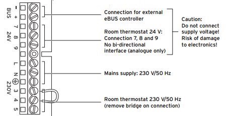

Hi I have read lots of threads about installing a hive unit to my combi boiler, its a ( Vaillant ecoTEC pro 28 ) I have connected the unit up at the boiler using the existing wiring with the link between L and 1 and switch wire out from 3 ( seems to be the correct wiring according to these forums )but it will not fire up at all. green lights on the unit and hub but nothing is happening
when i remove the stat and put the original back on it works no problem. all I done was connect the cables like for like but it will not fire up the boiler
would it be something to do with the hive set up or do i have to do something with the settings in the boiler to get it going.
thanks for your help lads
