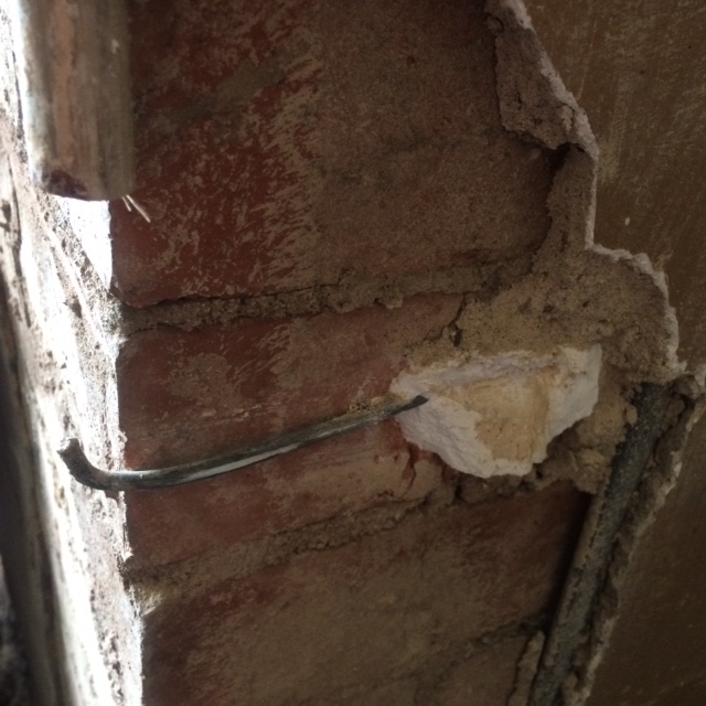

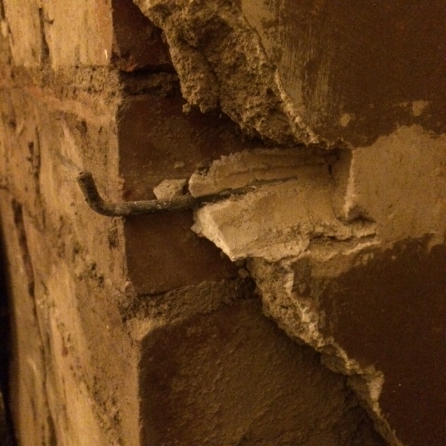

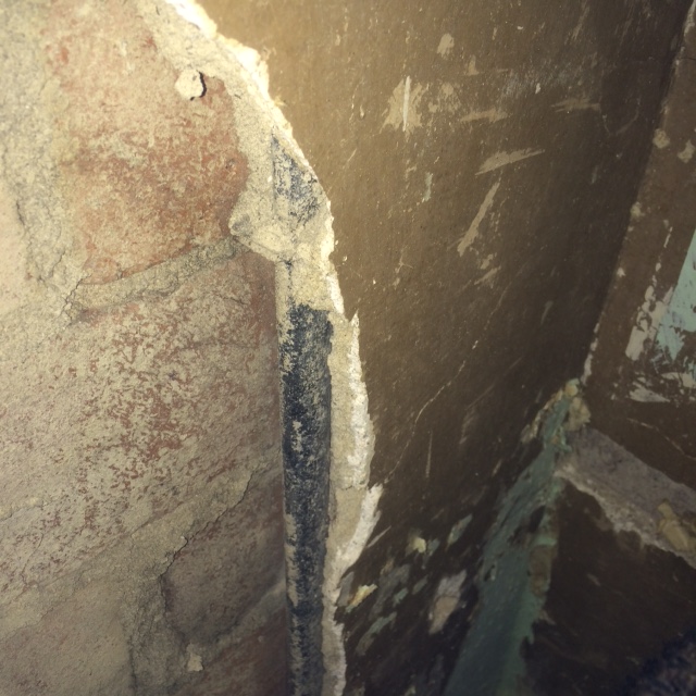

The only thing that I can find that might be something to do with is the tube in the first picture - it's around the side of the chimney breast and was covered in plaster - is this it?
The other picture is of an oval tube in the plaster which I assume is the electric cabling?

That appears to be the gas fire supply pipe - only copper pipe is not oval?
Given the already made disturbance you could trace that pipe (follow the white "plaster") back to where it probably comes up from the floor and cap it below the floor but only after determining that it is redundant?

The pipe is steel I think. I've pulled away plaster and it seems to go inside the chimney breast - could it be an overflow pipe?
I know nothing at all about how gas fires work.......
What does anyone think?
