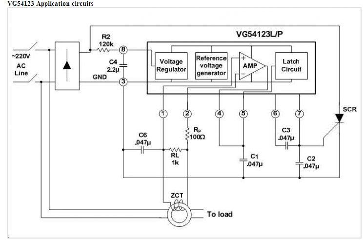

I've just had a look, and it's definitely 'control electronics'. There is a bridge rectifier to provide the power and the active component is an (8-pin SIL) VG54123 IC, which is a 'Ground Fault Interrupter'.

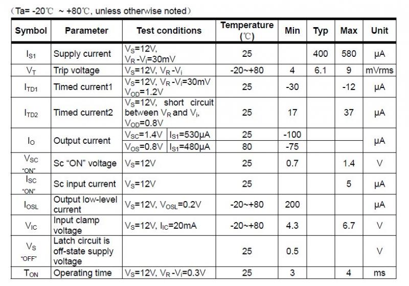

I've just had a look, and it's definitely 'control electronics'. There is a bridge rectifier to provide the power and the active component is an (8-pin SIL) VG54123 IC, which is a 'Ground Fault Interrupter'... I will investigate further!
Typical appllication of VG54123:
and Operating Characteristics:
It's simply amplifying the signal from the sense coil and then using an SCR to trigger the trip solenoid. There's no way it will work without the elctronics working. However, with a typical operating current of only 0.4mA, maybe it will carry on working for long enough from the capacitor (2.2μF in the Application Note), even if L-N pd disappears.
Edit: on reflection, even if the capacitor did keep the electronics working 'for long enough', the SCR would not be able to operate the trip solenoid if L-N pd had fallen to near zero - so I remain a bit confused.
Edit 2: ... unless, of course, it's a 'normally activated' solenoid!
Kind Regards, John
