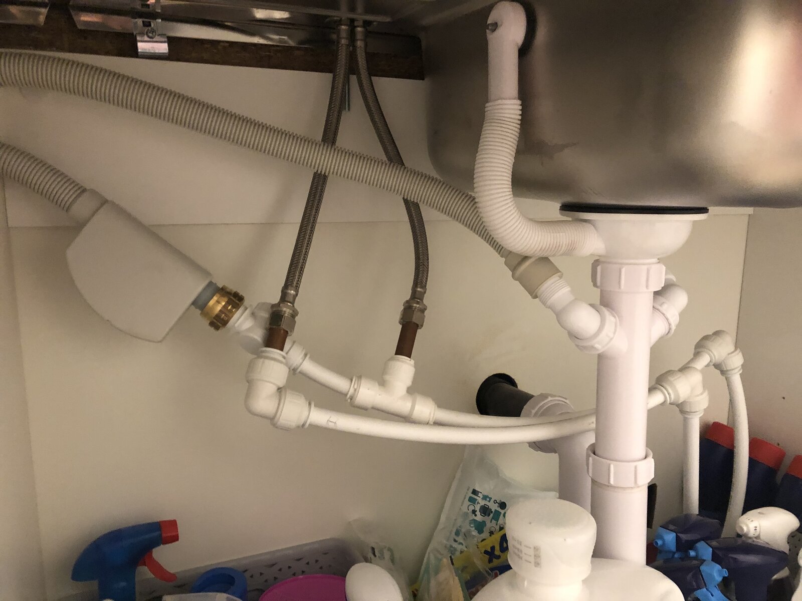

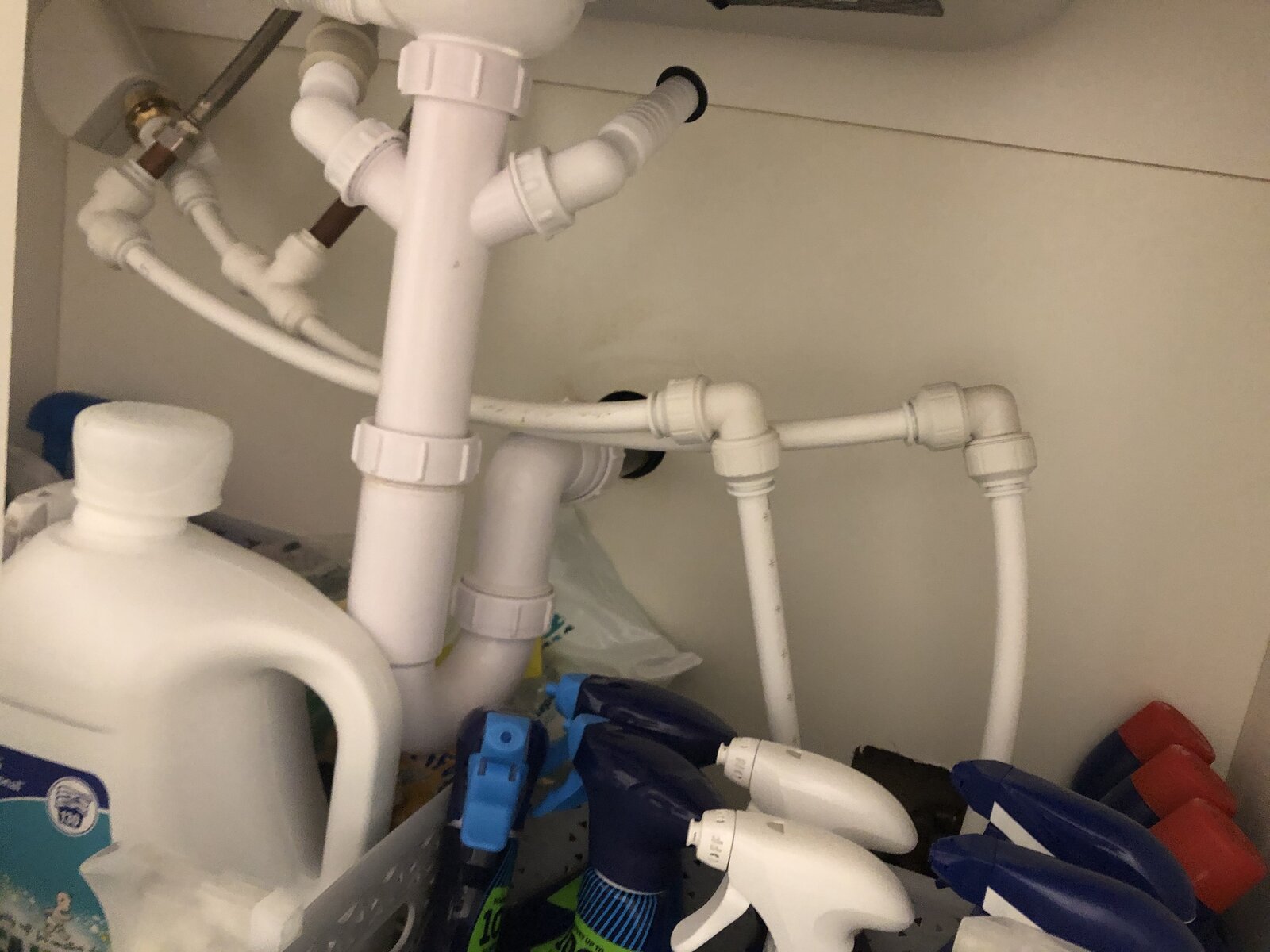

A few pictures of what the pipework looks like today to see if I need to alter the pipework etc.
From what I can see there is a cold and hot feed coming in front right to left, the cold T piece is for the tap and the washing machine.
The waste water from the washing machine goes into the left hand outlet of the main middle pipework ( sorry not technical so probably got the names totally wrong here )

The hot and cold supply pipework is a bit of a lash up quite frankly, with Unsupported pipes and joints under strain. The waste pipework under the sink ain't too bad ,and typical of a lot of set ups. There are two inlets for appliances ,one of which is in use and the other one should be capped ....is it ?
A better set up would be for appliances waste to go into a seperate standpipe and trap ,rather than go into the sinks waste pipe ,which have a tendency to gurgle .

Thanks for the post, I’ll look to get the inlet feeds changed to proper pipes and I believe there was a separate waste pipe for the washing machine behind the washing machine but I would need to double check.
The 2nd appliance inlet is capped off with a rubber bung.

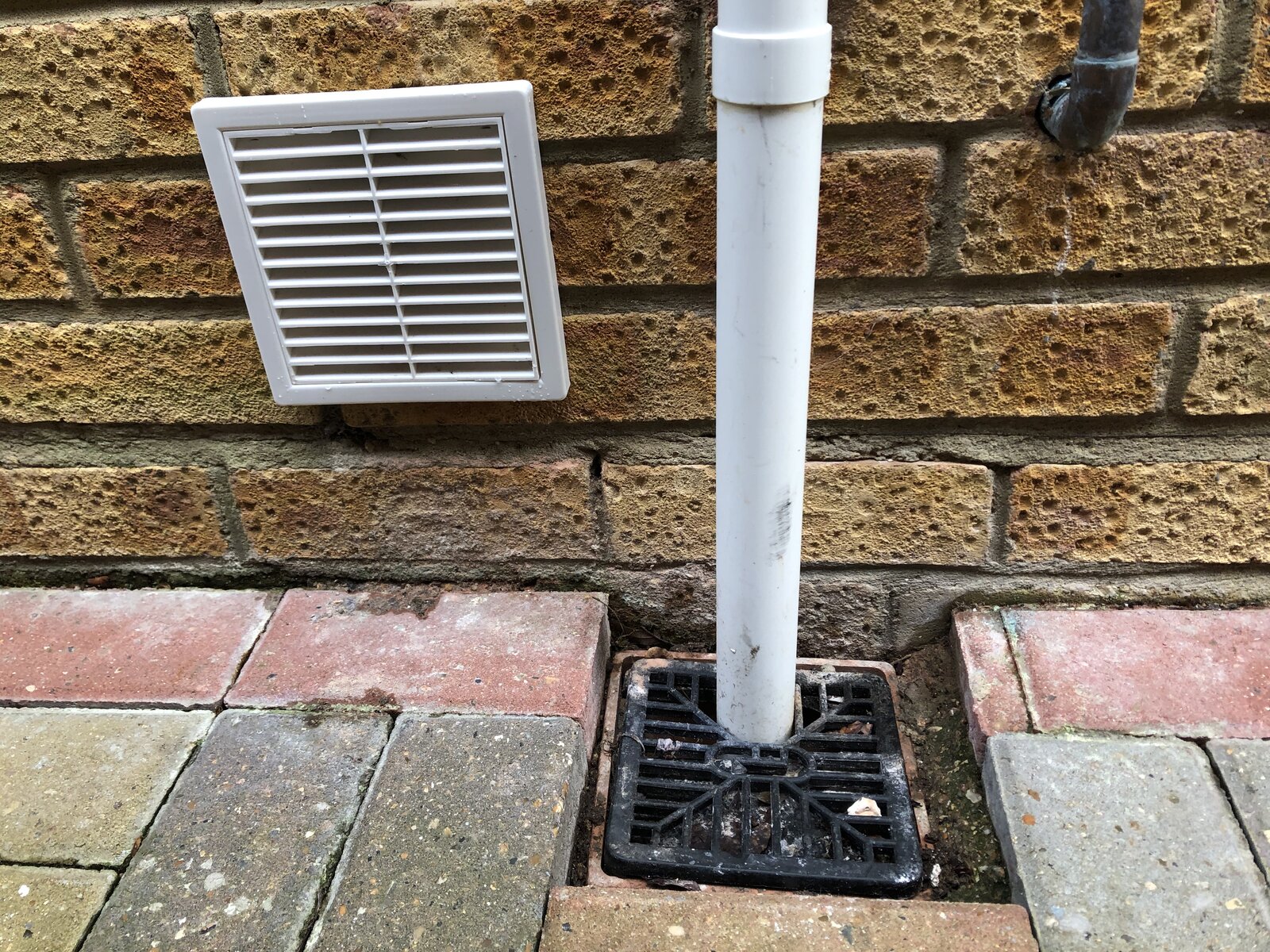

I believe it just runs through the wall into the outside drain

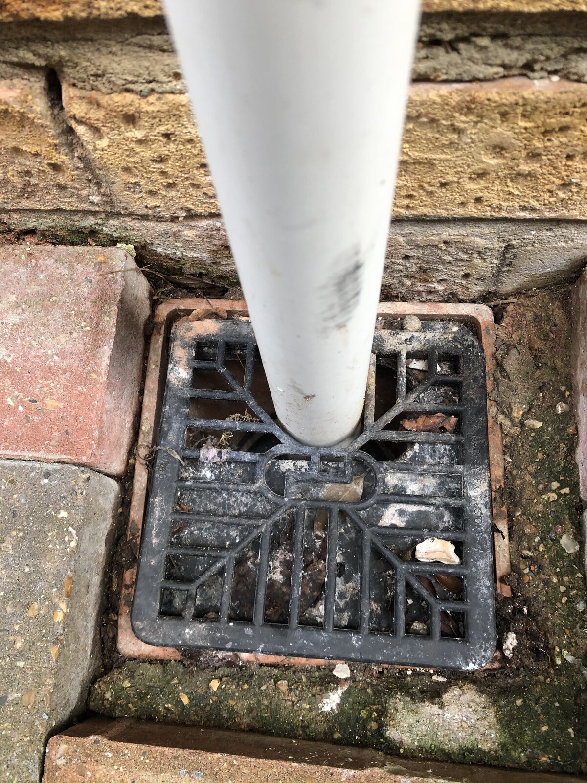

I did notice yesterday that after a good hand wash the drain outside wash full of bubbles, I have removed the leaves that covered the drain cover but still the same
Hope this makes sense
Stu
Show us a pic of outside drain and the pipe going into it. If the end of the pipe is submerged in water it will gurgle away every time !!!

Outside pics of the drain
