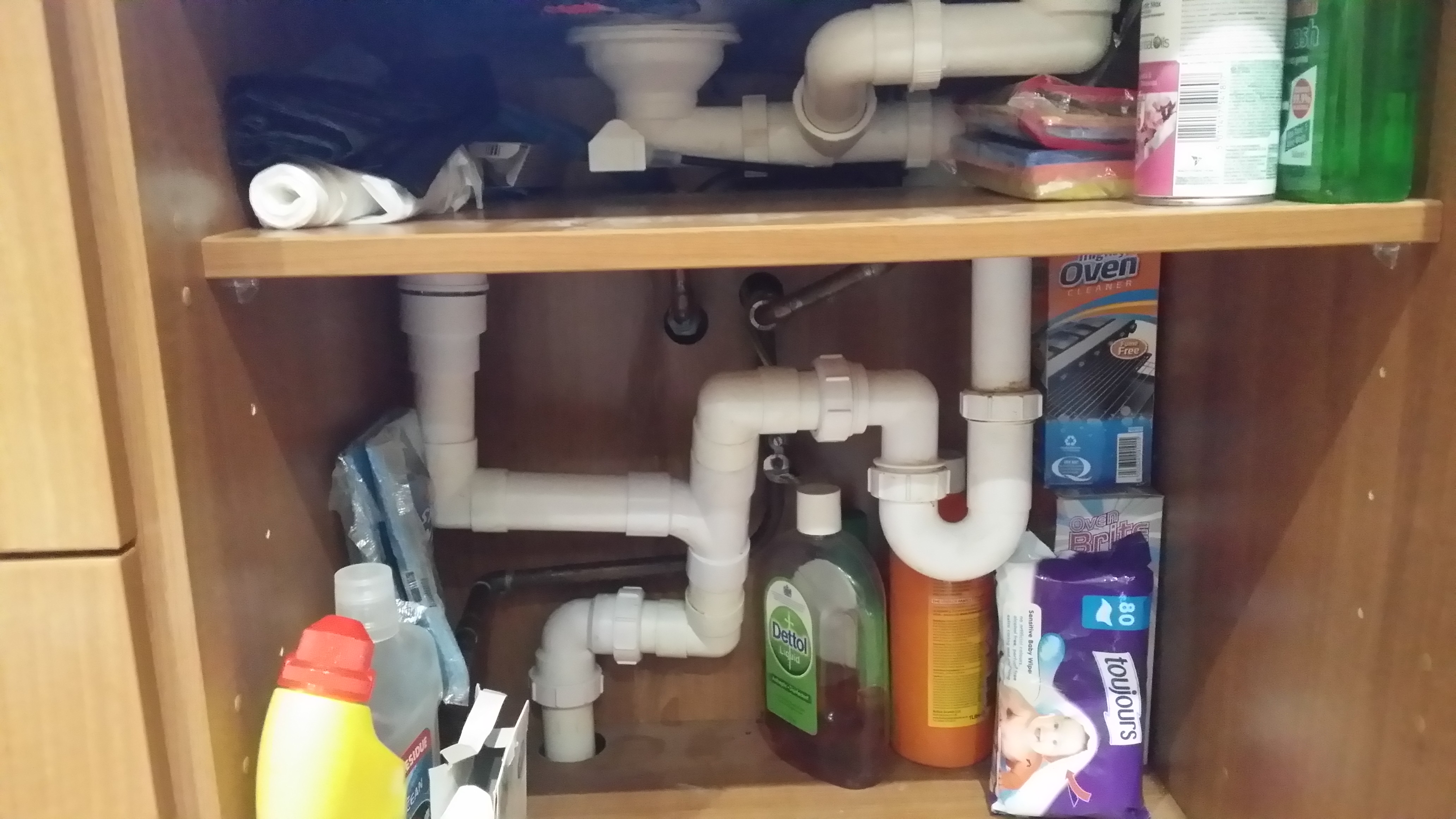

Tell us what the prices are ..... some " drainage" companies would cost you as much as it would be for me to have a holiday in Worcs. and fix your problem by taking a day out ;) And post some pics. of the pipework and where it goes.
The initial price to assess the problem is £110 +vat but that includes the rectifying of the problem if no parts needed...if parts needed then the cost of the parts plus £60 per hour + vat....the pic is pipework under the sink....I cannot access the pipes behind the wasging machine etc as the appliances are in front and I cannot lift them on my own but from memory they consist of a U trap,then a pipe going straight up for washing machine tube to fit into for draining washing machine....hope that helps...many thanks

If that AAV is working correctly then there should be no pull (gurgle) on the sink trap. The utility trap is another matter of course.
Gurgling is usually down to the volume of water in the pipe filling it completely, that plug of water then cause a vacuum behind it and that vacuum then pulls air through the trap(s) making them gurgle and antivac traps/aavs would usually cure it. A blockage/restriction in the pipe wouldn't usually cause syphoning, normally a blockage would back the waste up and then cause bubbling up through the waste, it's a different sound it makes.
Installing larger 50mm pipework downstream may be the way to go. Any idea of how long the overall length of the waste pipe is till it hits the main soil outfall? Has it always gurgled?
