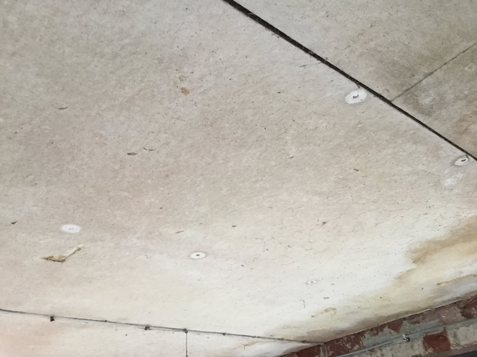

Hi. I’m about to board over the ceiling in an old garage, which I’ve kitted out to be a bit of a garden room for the kids.
Before I drill any holes in the ceiling, does anybody think there is a risk of asbestos? I have absolutely no idea what I’m looking for.
Thanks everyone. Sorry if I’m wasting anybody’s time, figure better safe than sorry

Utter guess,went to house few weeks ago and whole house had asbestos boards looking exactly like those pix.

In the first image posted the screws are seen to be recessed into the surface of what must be Plasterboard, if the boards were cement bound Asbestos then the screws will not be recessed, the ceiling board appears to be Plasterboard, not Asbestos.

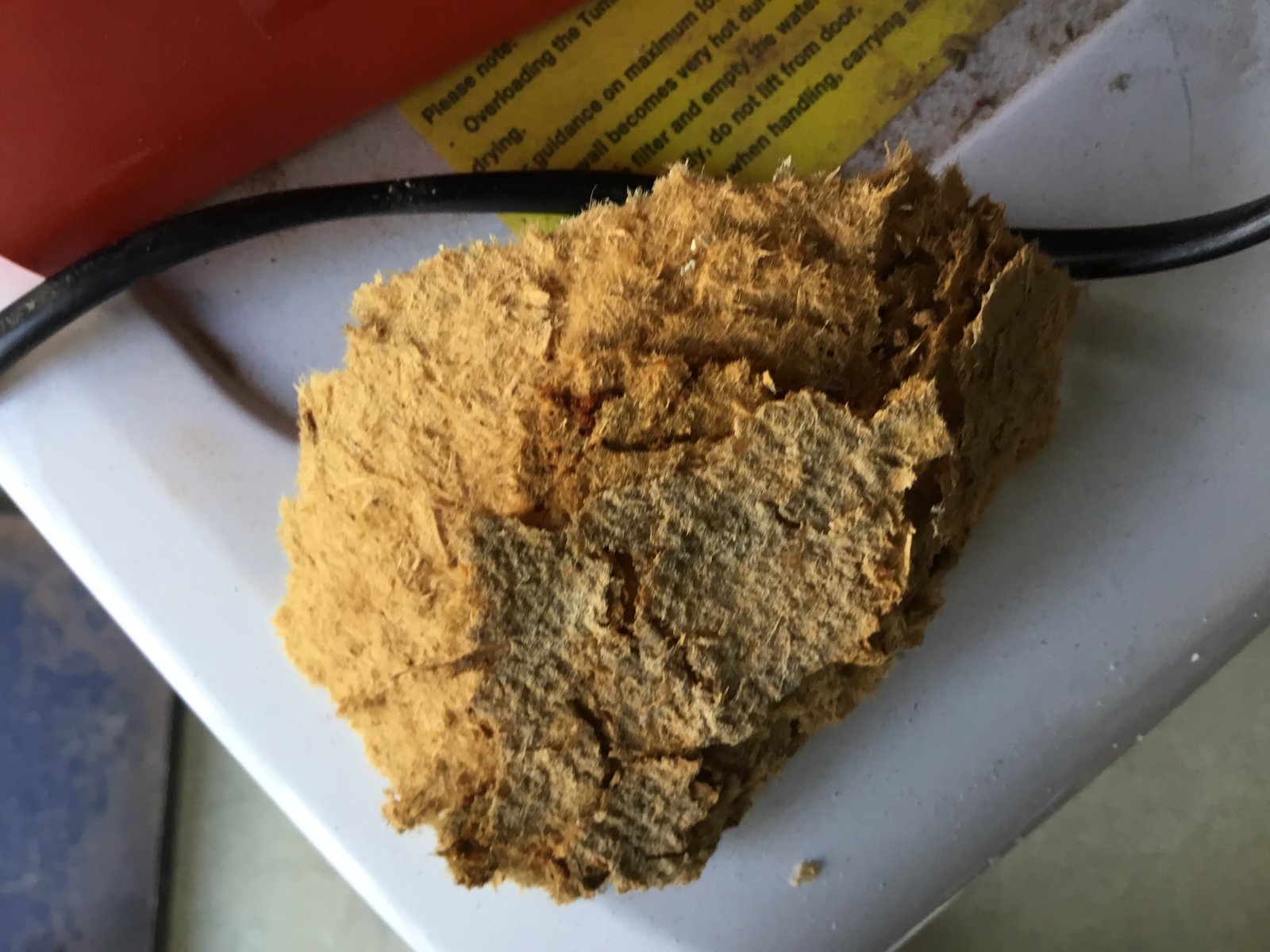

Image 2 appears like one of the fiber Boards, Cellotex or similar?

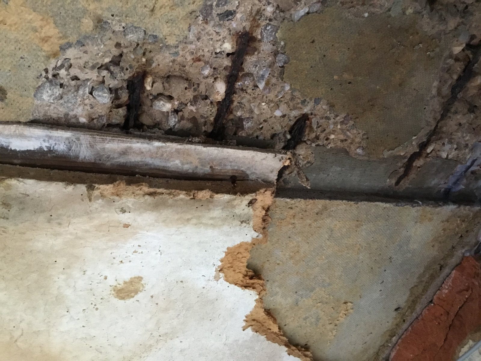

image 3 ? two differing materials, the material nearest the bottom of the image is again Fiber Board, as for the material on the upper portion of the image has small inclusions of what could be small gravel or stones? not really sure what that material is?
