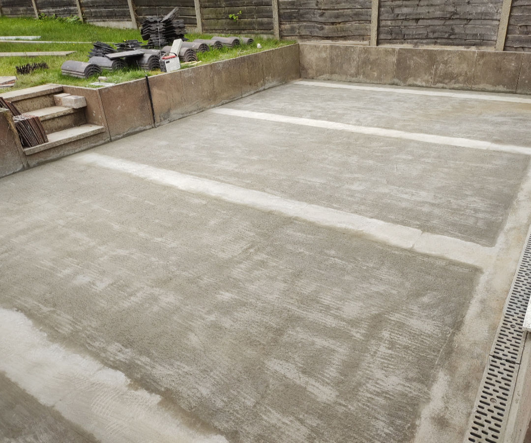

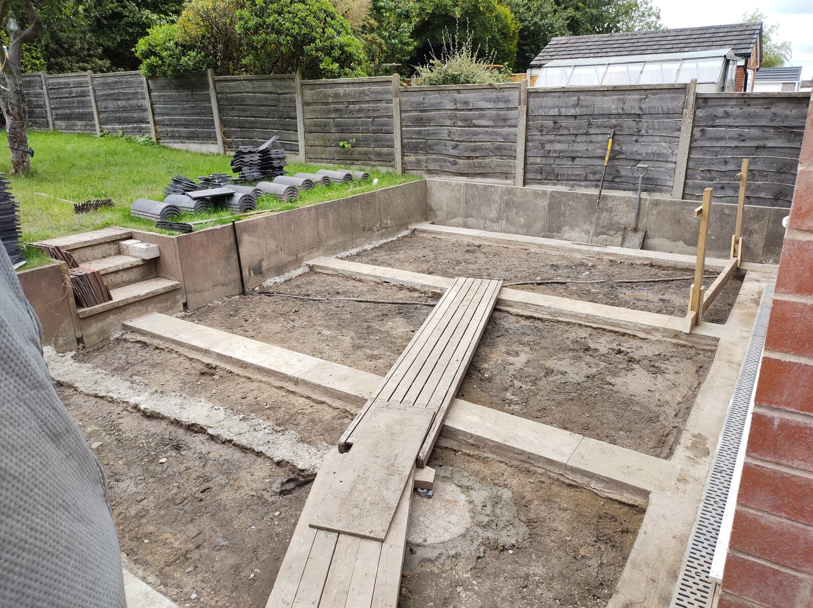

Thanks all - so on that note, my tiles are nominal 25mm (though reclaimed/rustic style), how far off FFL should I aim for?
I concreted my 20m² patio and tiled straight onto it. Just set up your screeds accurately.
A lot depends how big the slab will be. I set ply vertically with a laser level, and stacked a load of 6" blocks to the outside. Having used the laser, I knew the ply boxing was within 2mm accuracy.
Filled the box I'd made with concrete, and used a length of 4x2 wider than box to level it out, sliding it back and forth as we moved over it. Did 3 passes and walked away, only coming back to spray a bit of water on before bed,
