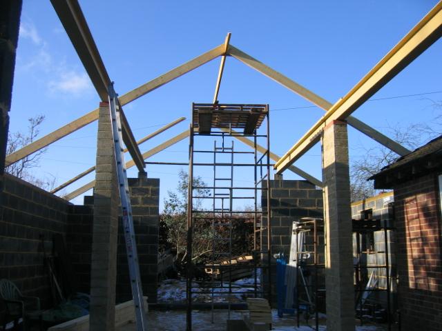

I have recently constructed a large lean-to extension on my gaff and am just about ready to hit out my rear elevation.
The steel column and 2no beams have arrived and are huuuge and darn heavy (350kg). Took 8 of us to drag around and lay in position.
I have been scratching my head on how to physically get them up into position without hurting anybody and staying safe.
I really need some real world advice on how to go about it.
I have loads of acros, 2no block and tackles, some small tower scaffold, scaffold boards and trestles.
Initial thoughts are to swing into rough position with an engine hoist, then build tower over each end and winch up each end onto a trestle, then winch and acro until close and then acro the last bit.
Any thoughts on how to keep safe and get them into position appreciated.
Thanks in advance

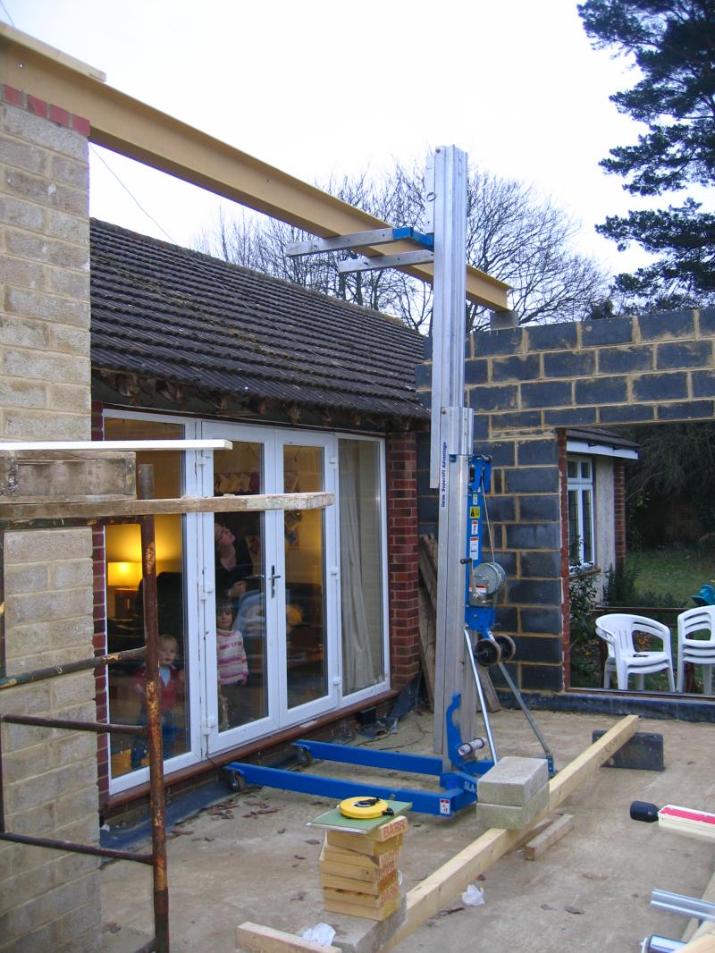

Google Genie SLA 20 super lift hoist. Will lift 363kg.
Most decent hire centres have them. We use them all the time for lifting and placing steels.

With the equipment you have its quite easy as long as you take your time.
You will need two small scaffold towers or one split into two units.
Put part of your tower either end of your RSJ, i.e. beside each of the pad stones. I said part of your tower as what you do is lift one end of the RSJ onto a partly built tower and then the other end onto a partly built tower so that you lift the RSJ as you build the towers in say 2 foot lifts or as your tower allows.

Liking the Genie lift. I have an engine hoist to get the beams up to waist level and then can slide the genie in underneath for the big lift to floor level.
HSS have an SL10 which looks perfect (thanks for the idea, this is what i needed was some real works advice).

Like this. I will use this logic to get up to waist height and to also build up as temporary protection with the steels in case the genie fails etc.

OK, that's a big span for a domestic. Column sections do allow a shallower beam but that's a lot of weight to be lifting and placing above your head. Definitely the beam lifters are the best option. Only thing is you never seem to be able to get them exactly where you want them with acrows and strongboys all over the place. Good luck.
Just get the steels 6" off the ground and the gennie slides under. Problems to think about: can you the lift in the middle of the steel for balance, the front wheels may stick out too far forward and hit a wall.
Thanks to all.
I hired a Genie SL10 (thanks to your advice) and it worked an absolute treat.
Lintels (and the column!) lifted in place easily and no one hurt/backs put out. All well all around!.
