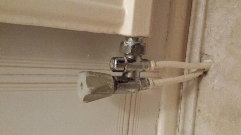

Morning All,
I awoke this morning to a bit of a leak from the radiator in my bathroom. Not huge, it is just dripping slightly from the valve. I have had a look on youtube and know I can fix it temporarilly using some PTFE tape. However I don't see any way to get the tap head off to get to the bit underneath it.
There is no screw and there doesnt seem to be any push mechanism. I don't really want to replace the entire valve because that will (I think) mean draining the entire system. We have only just moved in and I have no idea how to do this as it has two water tanks in the loft and not the combi boiler that I am use to.
Please tell me I am missing something and I can just remover the tap head?!
If the screw is removed you should be able to wiggle the head up and off.
If stiff, sometimes I put my pump pliers across for a better grip.
Careful not to much pressure that it cracks

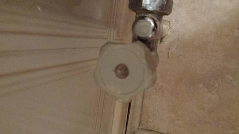

Thats what I thought but there doesnt seem to be a screw in the tap. I assumed they all came with one but this one doesnt
No screw means a push fit.....it's probably jammed with lime scale etc.
There's no guarantee the valve has a gland that can be packed, unfortunately....best give us a pic with the head off if you can.

Oh dear, the good old microbore twin entry valve. The cap is usually screwed down as suggested.
Looking at it, as you mention, there isn't a screw down there. I cant see clearly, does it look like there was a screw there at one time? If so, then a pair of grips below the plastic head and tap up on the grips may lift it.
You may have fun with that valve if you can't repair it. They are like hen's teeth to source.
No the hole in the centre seems completley filled. WIll try some to wiggle it with some pliers or push and hope for the best. If it is push fit is it push and turn? If so what direction?

If it's a push fit then it should be straight up to pull off though there usually isn't a hole in the cap, if you see what I mean. There's no need to mould a cap with a depression in the plastic. Unfortunately the screw head can snap off sometimes. Without being there it's hard to offer how to get a problem cap off.
